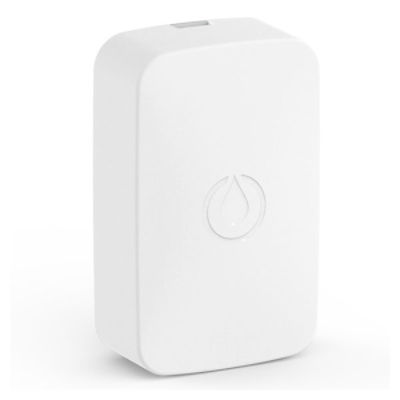

I just realized my Smart things water sensors also dropped, the device health feature obviously doesn’t support these sensors. This is some life threatening flaw that one cannot tolerate, I recommend everybody reading this test your water sensors now.

@rolled54.Why, i checked the above sensor and looks like Device Health is enabled for that specific one unless I’m missing something. Are you using a custom DTH by any chance? If you want I can dig into the events from ur device. You can email me more info to arun.rao@smartthings.com
Hi, I was wrong, it actually didn’t drop off, or maybe it reconnected on its own, the alarm went off 20 minutes later when I was having launch.
