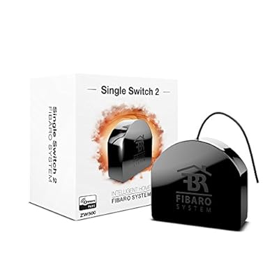

Is this a true dry contact with isolated NO/NC contacts, that’s what I’m looking for. Or is it meant to connect to 120VAC and switch 120VAC on and off. It’s not clear from the amazon link?
Excellent that will work for me. I imagine I can also get it in a single N/O configuration?

Vesternet used to have a US site, but they don’t anymore, they’re only UK now.
The smartest house is a Fibaro – authorized dealer in the US, but they are only listing the newer model, the 223, and if I recall correctly the dry contacts were removed from that device because they had some fusing problems with inrush current.
http://www.thesmartesthouse.com/collections/fibaro
It doesn’t look like the 222 was ever released on the US frequency:
http://products.z-wavealliance.org/regions/2/categories/16/products?company=171
