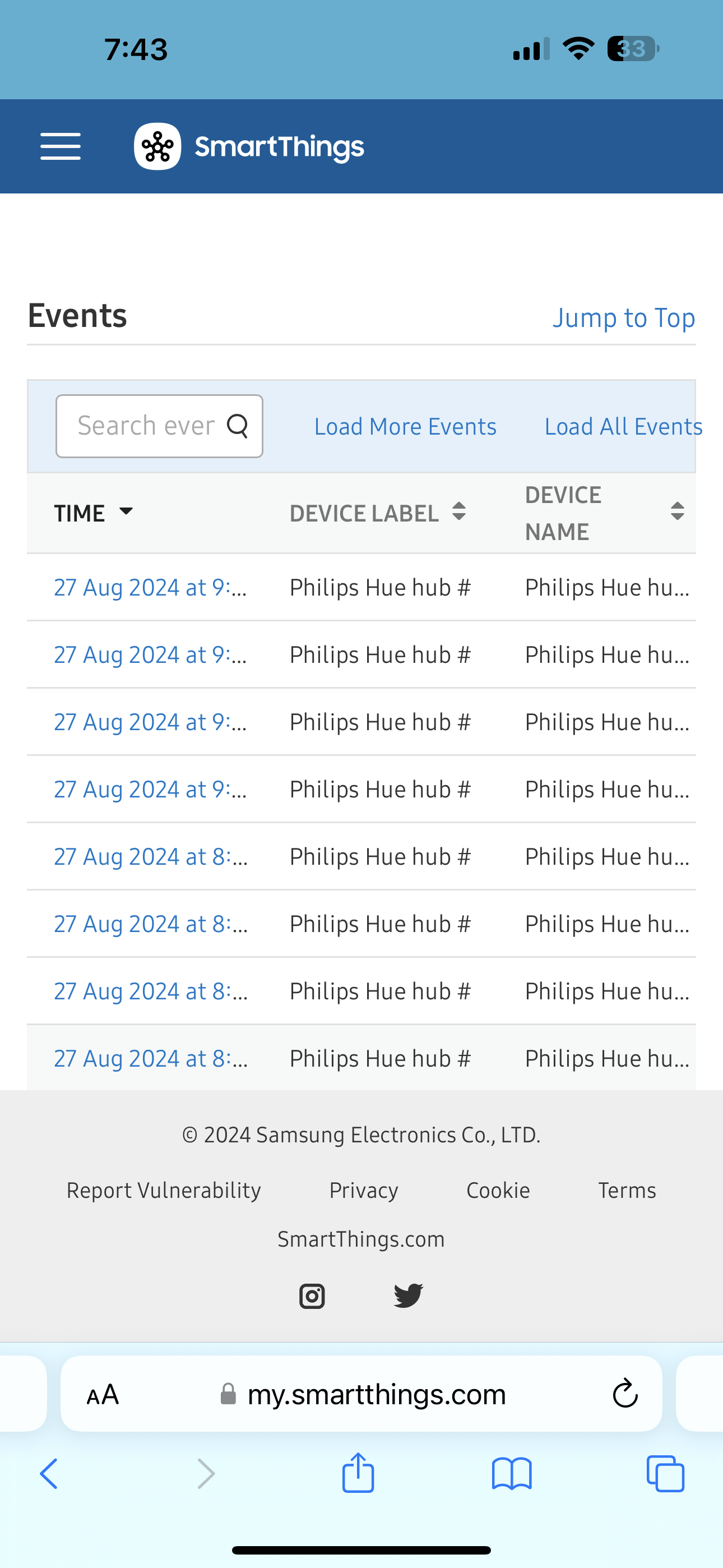

Have serveral errors after the firmware is updated on 27Aug
Both devices with lan services are now not able to function and error message shown per below
@Luis_Humberto_Medina , @nayelyz can you assist on this ?
