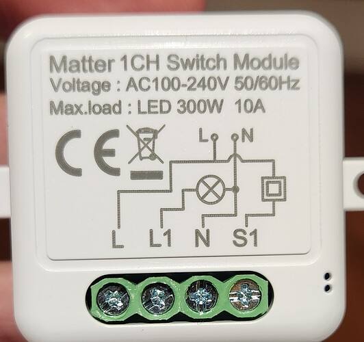

I need confirmation that there is no way for me to make this work. Because I have the load wire in one box, and live in another. I can’t figure out a way to do it.
Let me know if I am wrong… I know some of you are geniuses;)
You can make it work as a single pole/location switch but the secondary switch will no longer work because you don’t have enough wires going to the second switch to make it work as a smart 3way. This said if you want to make it work from the one switch with line power, changes to your fixture wiring will be necessary as well.
@JDRoberts, it’s a Matter switch I got from ali express. not sure that the switch model would be relevant here. But the switch picture and wiring diagram is in my first post.
@ritchierich Yup. so you confirmed my fears! The wife won’t be happy with one location
