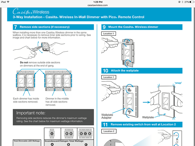

The Lutron Caseta with Pico remote can I have multiple in one area. We have a 3-way light for our dinning room light and one for our kitchen ceiling cans. All these switches are located next to each other.
If you are asking if you can put two Lutron Caseta master switches side by side in a double gang box, each controlling a different set of lights, then yes. You do need to check the specifications to be sure each can handle the desired load.
http://www.casetawireless.com/Documents/0301710a_Caseta%20Advanced%20Inst.pdf
And then you can put the pico auxiliary for each wherever you want it to be since those are battery-operated.
If you have a dual gang light box you can also mount a master Caseta switch for one branch next to a pico auxiliary for the other branch as long as you use the extra wall mount piece from Caseta for putting a pico in a switch box.

OK what we have is half of our house is the dining room and Kitchen. In the dinning room on one side of the room we have one 3 way switch for the kitchen lights, one light for the dining room chandelier, and one single switch for the outside light in our garage. On the other wall in the dining room we have the other 3-way switch for the kitchen lights, the other for the 3-way switch for the dinning room chandelier and a single light for the dining room ceiling can lights. My concern is two switches with remote switches so close together. If they are “Paired” to the master switch then I should be fine.
Yes, with the Casetas each Pico can be paired to its master. See the wiring manual I already linked to above.
