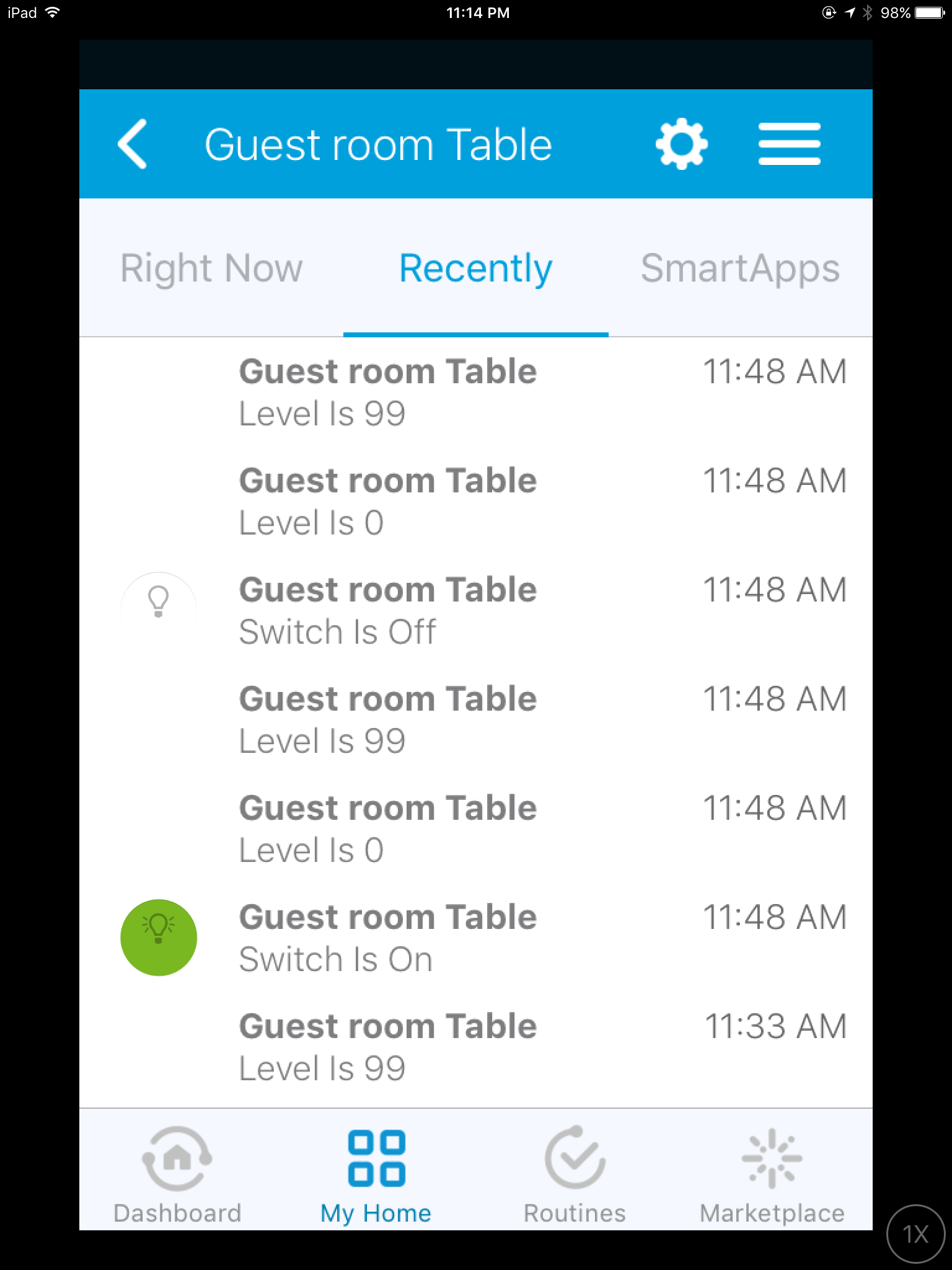

This is from today. It’s one of the things SmartThings sometimes does with dimmer switches. The switch is off, but the level keeps cycling between 0 and 99.

I just checked my log and it is empty for the one Leviton dimmer outlet that I have setup, I have a second one but haven’t connected it yet. This dimmer outlet is connected to a standing tiered light with 3 standard LED bulbs (not smart bulbs) and the lights have never come on without me turning them on and they turn off when given the command. This is actually one of the few devices that I have never had to re-pair due to loss of communication like some of my Cree bulbs and various sensors.
I am curious what device handler your switch is using, mine is using the standard “Dimmer Switch” device handler.
