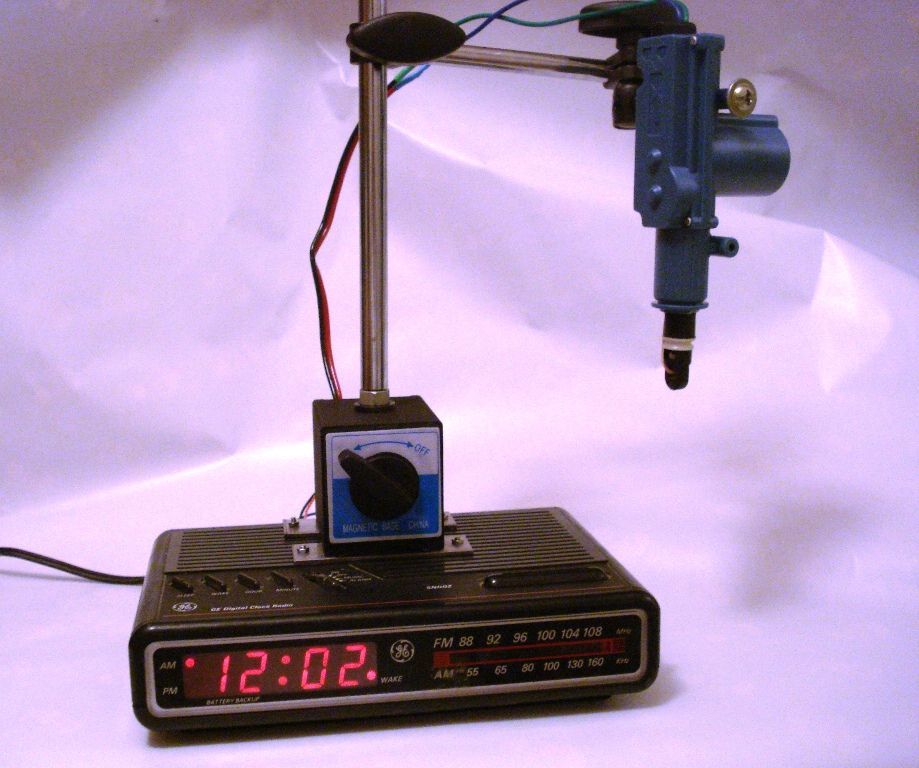

Too funny, I was going to mention maybe creating a device that you can remotely control that would physically pull the plug from the socket and then plug it back in

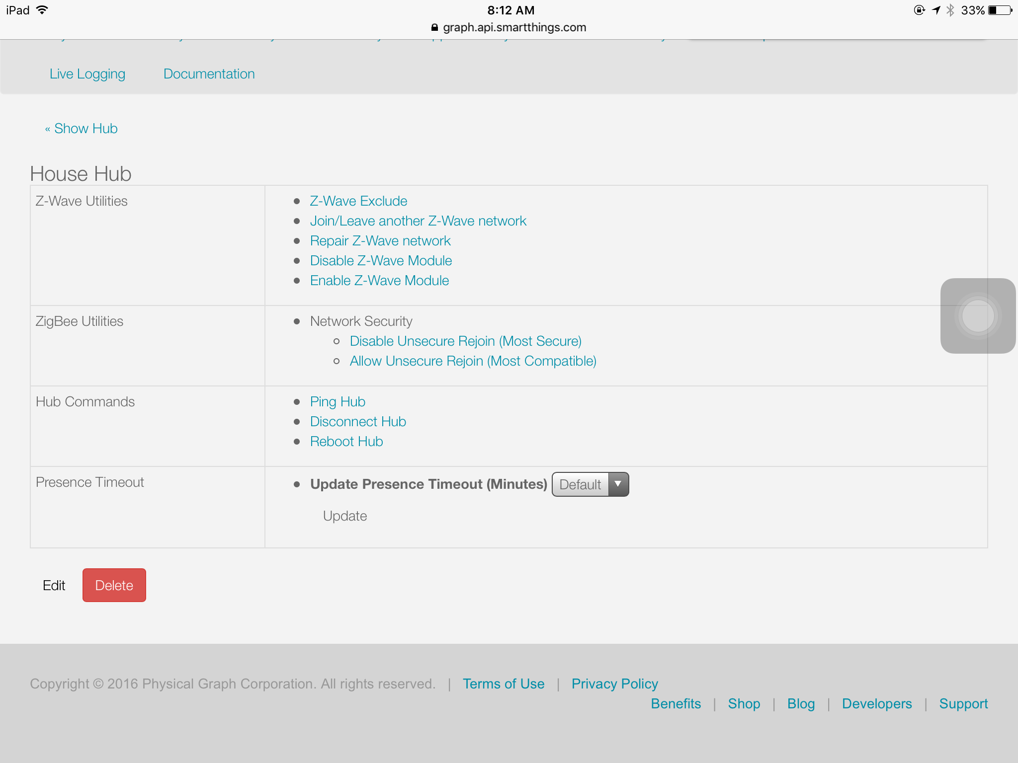

@motley brought this up earlier, but if you just need it for occasional use rather than a regular maintenance schedule, why not just use the reboot utility in the IDE? Sign into the IDE, choose hubs, and then utilities.
