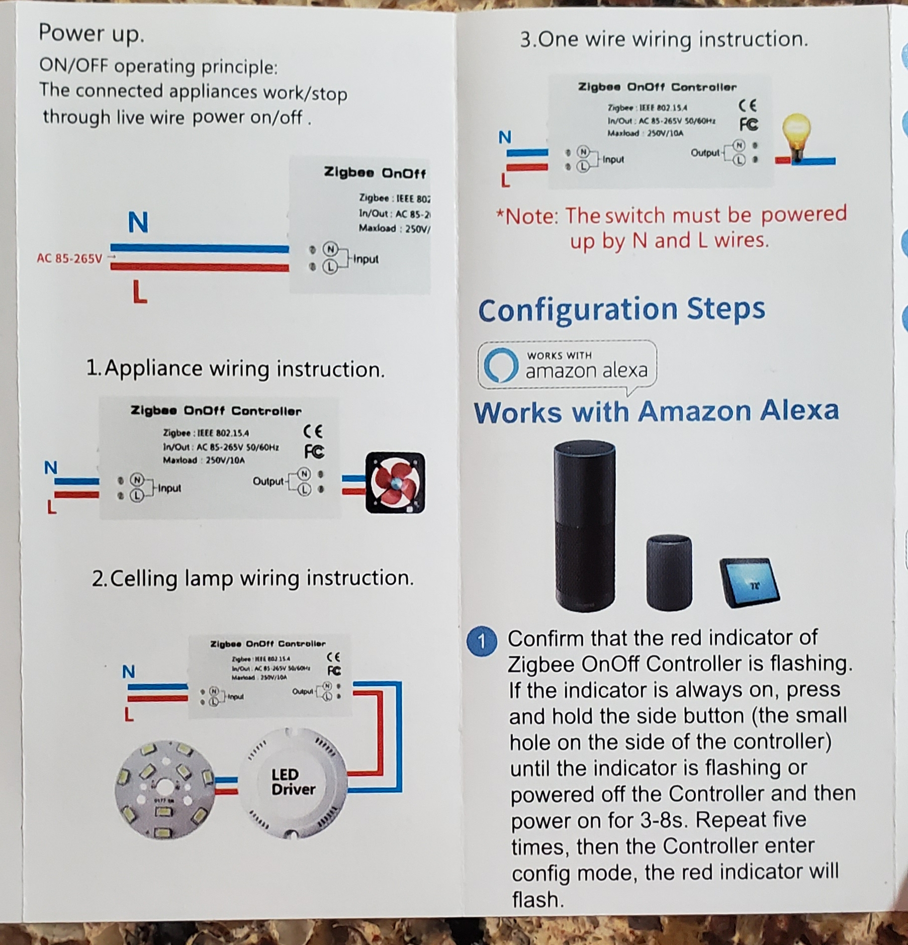

Can one of these be used to control a ceiling fan? If so, this is exactly what I’ve been looking for! I bought one to test it out but I’m not sure how I’ll wire it up yet. I want to use it to power only the fan but not the bulb because I use Hue bulbs.
Well it shows a fan in the picture, not that they ever lie about that type of thing. Obviously it would only be for on/off & you’re going to have to use the pull chain for changing speed.
Of course the description also says that it is perfect for adding voice control to your washing machine .
Of course. I have one physical wall switch always in the on position for my ceiling fan and Hue bulb that is covered with a new Lutron Aurora dimmer. I want to go into the ceiling fan and wire this device so that it is only connected to the fan motor (blue wire).
