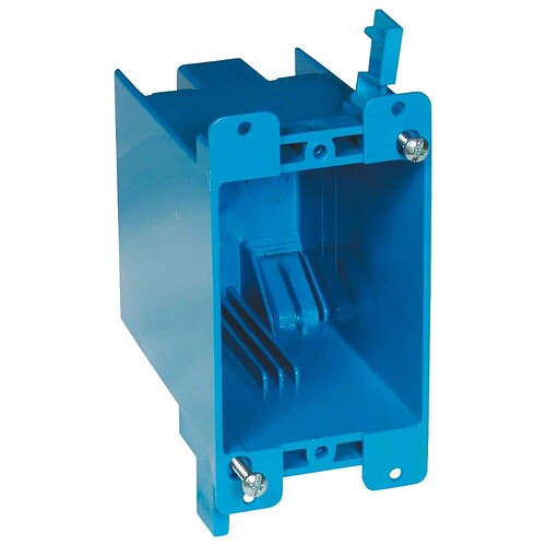

Not even vertically?
Something like this makes it easy to add another box:
Physically, no space for another one. Short wall, lots of framing. Thank you though I appreciate it.
