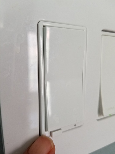

- Pull out the air gap.
- open the app and go into the device settings for the switch.
- tap replace
- when ready, push in air gap and then turn on the switch. You may need to turn the switch on and off multiple times until the app said replaced.

Sorry but what do you mean airgap?
Yep, @BBoy486 thatās it right there
