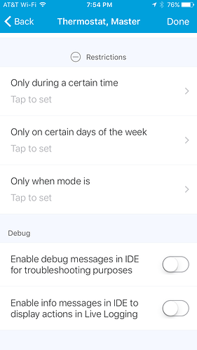

zThermostat Manager is not working
I downloaded the Thermostat Mode Director to help change the settings on my thermostat based on the weather getting hot or cold. The automations seem pretty straightforward, but the one I set up is not working - see screenshots below.
Can anyone tell me what I’m doing wrong here?
Thanks!
That’s my app. Give me about 30 min to get home and I can look to see what problems you have.
When you say is not working, what do you mean? The temp fell below 59 and the tstat did not change to heat and set the 69 heating setpoint? Could you do me a favor, please and tell me what t-stat do you have. Also, can you go to live logging in ide and then to your app and flip both the debug and the info toggle. After you click done, go back to ide and post the lines for your app. Thanks
The temp did fall below 59 and the tstat didn’t change. Also, the temp rose above 75 and the AC didn’t change earlier this week.
The tstat is a Zen
Thanks for your help!!

Ah, it looks like you stepped into the bug that @jmccausland stepped into couple of weeks ago. Can you please update to the last version and see if that fixes your problem? To test it, copy/paste the new code. Then go to your mobile app and set the temperature just above your outdoor sensor whatever that might be now. Then click done and wait 2 min and watch it adjust itself. I would do it with live logging on just in case it still not working. Also, when you are in live logging, please click at the top on the name of your app. That way, it will only display the logging from that single app.
Here is the post/link to the most recent updated version:
[OBSOLETE] zStat Manager - #2 by SBDOBRESCU
It still didn’t work. The code is below. BTW, sorry for the extra coding logs. I tried clicking on just your app, but it continued to display the events from the other apps…

Ok, I see the problem… The away mode is optionally required :slight_smile: Meaning that you can skip it in the settings, but a value is required for the app to work. My bad! Let me think of a way to get around that and will update the app shortly. Sorry about that…
Fixed the bug, please update again and see if that works. I have tested the fix without Away setting and worked for me.
https://raw.githubusercontent.com/sbdobrescu/SmartThings/master/ZwaveThermostatDir.groovy
Not working :frowning:
This is the log now:

Ok, sorry for the delay. This error is really giving me a hard time…
Can you try this for me? You will need to uninstall your current app and then recreate your “Thermostat, Master”
Also, when in ide, can you please click to highlight the “Thermostat, Master” like in this picture?
Here is the new app…
