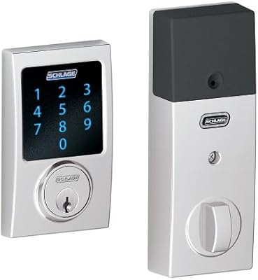

I am in the same exact situation. My kitchen door has a big glass window. I am already using this on my solid wood front door:
What I am going to do is install that same exact lock on the kitchen door and remove the little turning knob, maybe even replace it with a flat metal plate.
I will then install a small zwave switch or panel on the wall next to the door so when you want to exit you just press the button, and when the door is closed it will automatically lock. This will likely meet my needs, and hopefully will help some of you too :slight_smile:
This will very likely be a violation of code in your jurisdiction. Almost all places in United States require that in a building where people sleep you be able to exit the door even when there is no power without needing an additional code, key, or device.
Your Z wave button will not meet such a code because it won’t work if your power is out.
I assume from your description that your concern is someone breaking the glass and reaching around to turn the turnbolt.
An easier way to secure this is to put a box over the lock with a flip latch on the side away from the window.
It is very unlikely that someone could reach through and flip that latch, but the lock remains completely usable when the power is out for someone who is already inside the building.
This also keeps your warranty on the lock intact because you have not altered it.
You can still add your button for convenience if you want to, you just need a no power exit option as well. :sunglasses:
