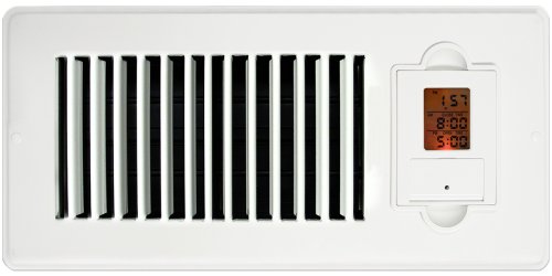

Hi @scottinpollock,
In my house, I have more than 20 vents and I’ve been using a dumber version of the Keen Home Vents for a while in my house built in 2003, and I haven’t experienced any issue.
I use a mix of standard vents and “wiser” vents on a timer such as those (which have been on the market for a while now):
If you read my previous posts, I have never recommended to replace all vents inside a home.
And, like I said earlier, my smartapps will not close all the smart vents.
Anyway, if you’re not interested by the product, it’s up to you, I’m not trying to convince you.
Cheers.
