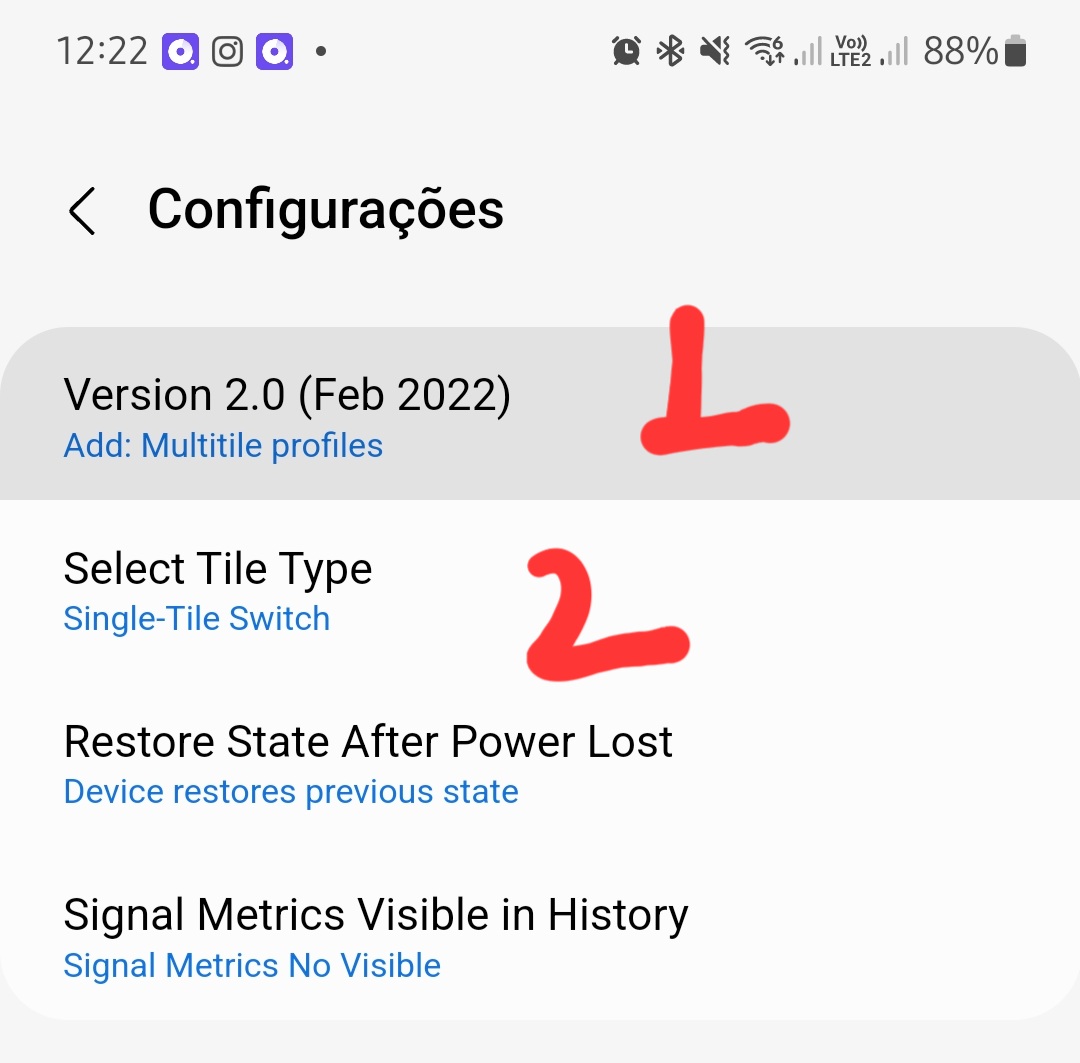

Hi @Mariano_Colmenarejo, there is some bug in Single-tile switch mode, itβs changing back to multi-tile mode:
Hi @Dienzora
I have 2 switches 3 gang profile and works fine for me in android app.
It change fine from one tile to another.
This has to do with the profile, not with the device size.
If You use Android delete cache the first time You change tile.
Hello, thanks for your timeβ¦
Iβm a iOS user, could be a iOS bug ?

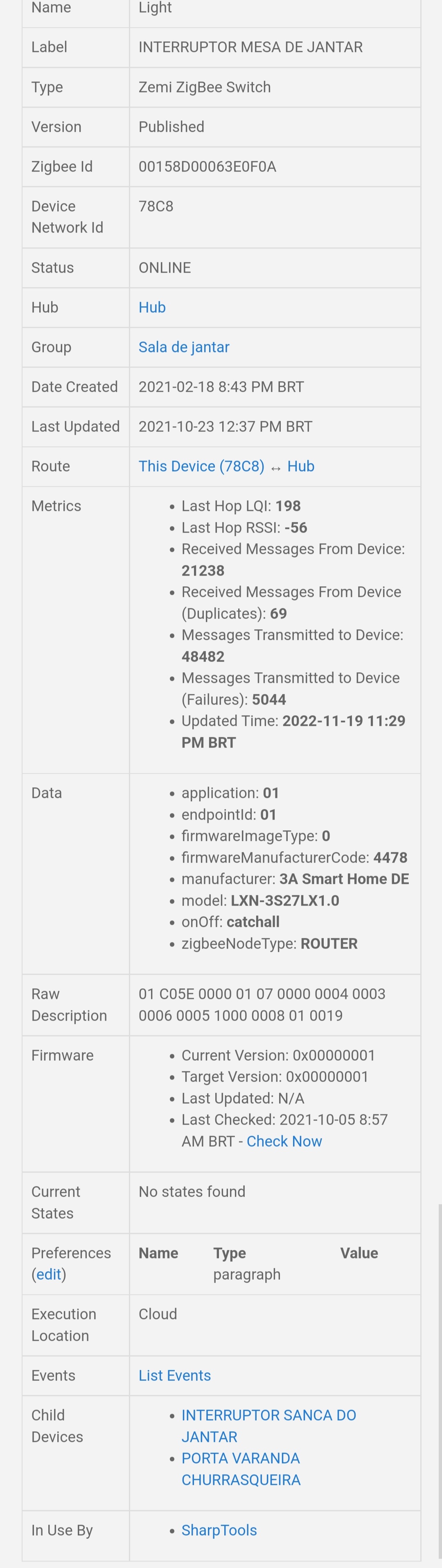

Iβm trying to add these zigbee switches but smartthings canβt find the devices. I already deleted all switches from the STH application, deleted the DTH from the IDE, put the devices in pairing mode, Iβm connected with the @Mariano_Colmenarejo drivers, but without success in adding the zigbee switches. Does anyone now how to solve this?
Thanks a lot
This is the switchβs fingerprint:
This was The IDE DTH:
This device is in my driver Zigbee Multi Switch and Child Mc as two-switch profile
This is my shared channel link

Thanks for answering, @Mariano_Colmenarejo !
Yes, Iβm using your drivers, but the appβs Scan wasnβt finding the devices.
I cleared the cache, restarted the hub and now it works.
Switches with 3 buttons are being read as βFeibitβ. Is this right?
The manufacturer was 3A Smart Home too and the fingerprint was:
Thanks for your help as always. The community is very grateful for this.

So, I must select multi-tile in item 2 of the figure and, in item 1, put the amount of switches I want to create for that main one, is that it?
I don not what driver You are.
the correct is zigbee Multi Switch and Child Mc
to create single devices are these preferences
Wow, perfect! Now it works. ![]()

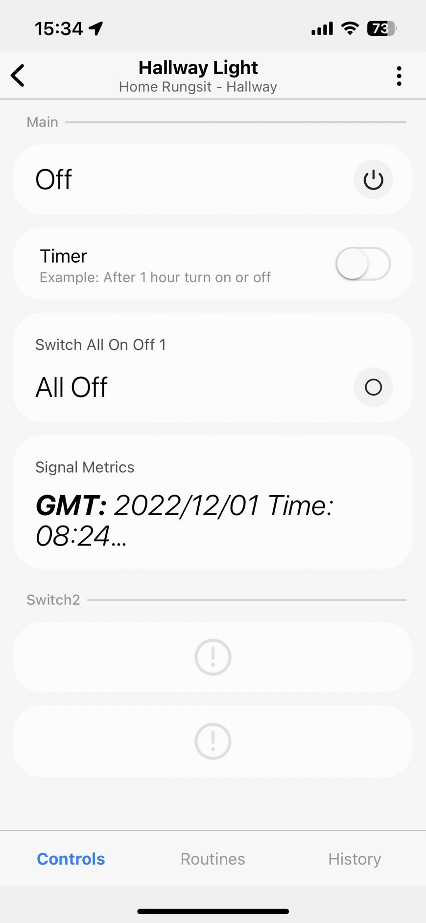

Hi @Mariano_Colmenarejo, thanks for your driver.
Iβve migrated my Zemismart Light switch both touch type and push-type switch using your driver. I have both 2, 3 gangs switch.
Now the push-type switch are migrated and start on some of the touch-type switches and I found the problem.
The push-type switch can be discovered and assigned without a problem. I also create an individual switch for each one.
For the touch-type switch, although it can be discovered but the status was available only primary switch, switch 2 or 3 has no status at all (please see the picture attached)
Iβve done exactly the same way when add the push-type switch. Any recommendation?
Hi @Kenny_C
Install driver Zigbee Thing Mc in your hub
Perform a driver change to this driver
Send me a capture of the fingerprints data of device

This driver version must fix the problem
This manufacturer tags the initial endpoint with the last endpoint and so the standard component assignment doesnβt work.
I have already detected three models with this problem
βFB56+ZSW1JKJ2.7β, βFB56+ZSW1JKJ2.5β, βFB56+ZSW1HKJ2.5β
This version will be updated in 12 hours maximum or install it with the CLI

The new driver is loaded and they work now.
Thanks.
