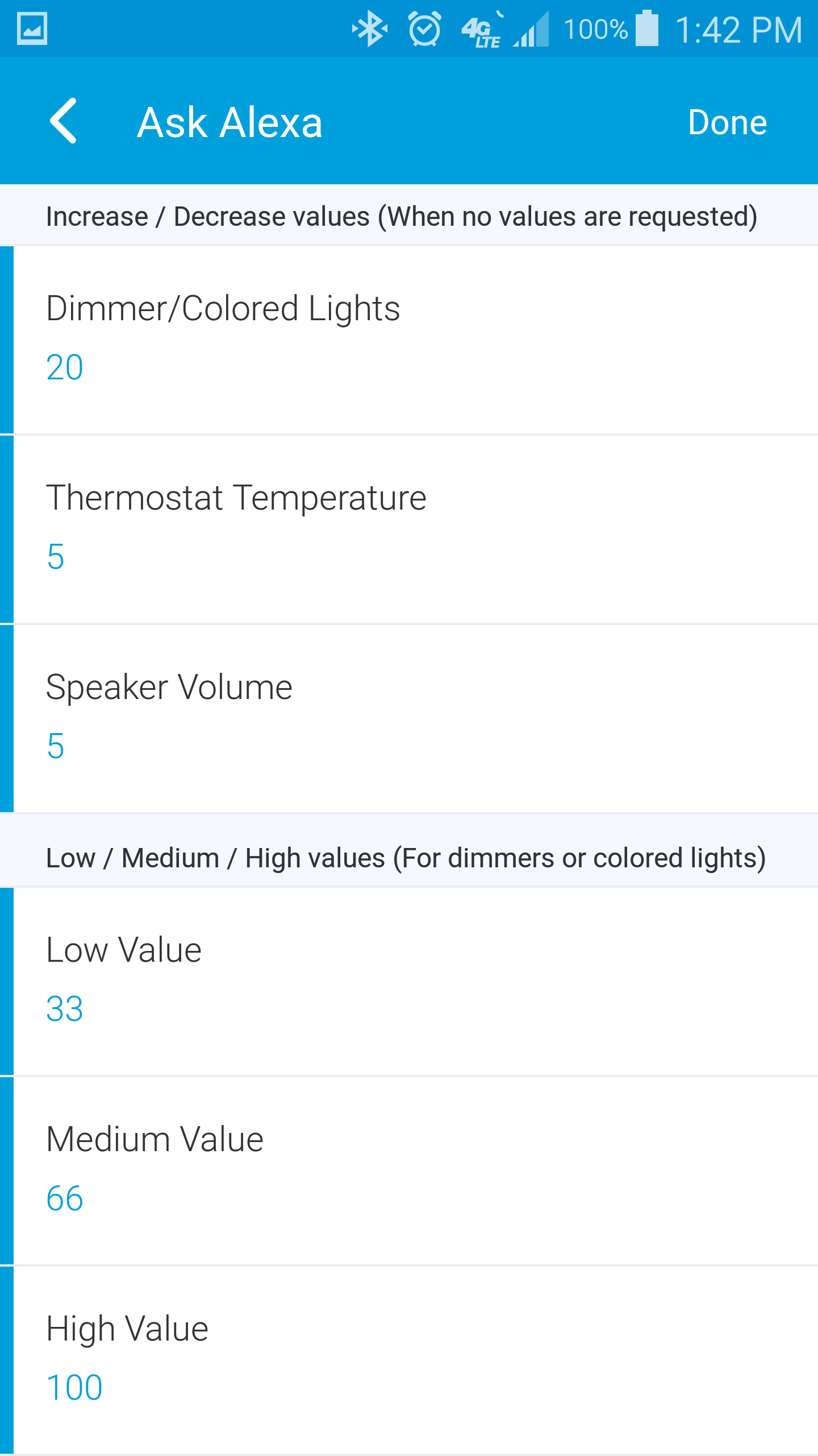

If the above doesn’t work though simply try adjusting up the lo/med/hi preference values as stated in the original posting.
