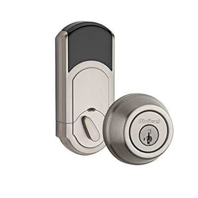

I’ve been looking for a traditional looking smart lock without a keypad. Only one I found was the Kwikset Traditional Signature Deadbolt with Home Connect. I belive this is a Z-Wave lock. Would it be best to wait until they come out with a Z-Wave Plus version for its increased security. Better range and better battery life would be a bonus, but more concerned about the security aspect obviously.

In my lock work (as a hobbyist) I would strongly recommend against the Kwikset EZ-Set locks (pictured). The physical lock tumbler is very easily opened without leaving a mark. The innards are plastic.

BTW, I agree that if you are very concerned about security, Kwikset is likely to be your last choice of the big three. Ask any locksmith. Yale and Schlage are in a different class.

The older Kwikset locks are OK, they are easily refitted with security pins, but the keyway profile is weak. I was being very specific about the SmartKey locks (see video).
Schlage is economical and secure (enough), I have their electronic combo locks on my house. Yale is better, but you pay for it.
