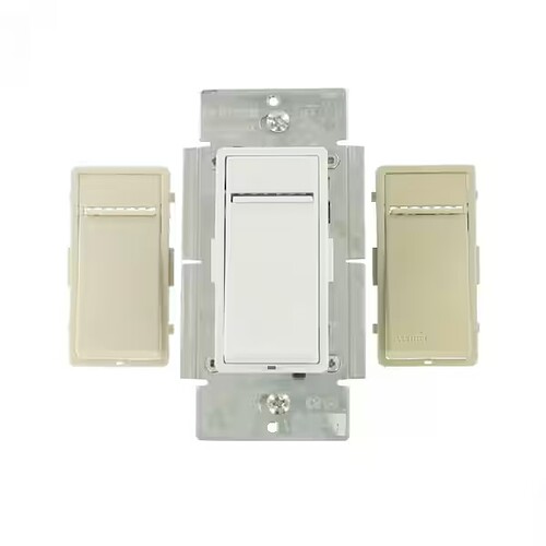

That style has pretty much gone out of fashion for zwave. About 10 years ago, Leviton made their Vizia RF+ Z wave line in that style, but it was discontinued several years ago. You can still sometimes find the devices on eBay or someplace like that, but I wouldn’t bother. The technology is getting pretty old.
If you do want to look for them, the Zwave models are “RF +”, not just “+”. (The RF stands for “radio frequency.” The plain Vizia + models are a coordinating line of dumb switches.)
Home Depot does still list a few of the vizia RF plus models, but at very high prices, and usually out of stock. So I include this link just so you can see what they look like.

I have one or two of the Leviton Zwave switches/dimmers that were this style (toggle on bottom). I can get the model number tomorrow but they are 300 series (non Zwave plus). I think they have white paddles.
The Leviton Vizia RF + typically came with three paddle covers in the box: white, ivory, and light almond. You just used whichever one you preferred.
