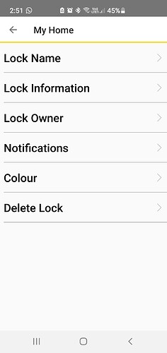

And here’s android. So many differences!!
So if you have someone with an iPhone, borrow it, do the changes you need and then switch back to yours.
You have to transfer keys between devices but the app does thus when you login so no issues.
