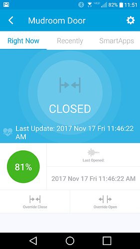

That other DH for the water sensor also had another interesting area about the battery. In the Tile he has it reporting a color BG as well. I modified it a slight bit but it will show a green BG down to 51% then go yellow from 26 to 50% then go Red lower than 25%
valueTile(“battery”, “device.battery”, decoration: “flat”, inactiveLabel: false, width: 2, height: 2) {
state “default”, label:’${currentValue}% battery’, unit:"",
backgroundColors: [
[value: 10, color: “#bc2323”],
[value: 26, color: “#f1d801”],
[value: 51, color: “#44b621”]
it’s now checked in a second time and I’m still at 81%. This is also the original battery that’s been in it since it showed up at my house.

DOH! Thats on me, my mistake. I made the same change too, if you look at my picture the word battery is missing. I just copied and pasted the wrong code, i took it from my notepad and not out of the IDE. Sorry for the confusion.
