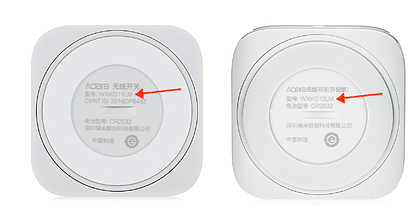

Can you share which Aqara Button model you are using? The model is printed on the back. There are two models, lumi.sensor_switch.aq2 and WXKG12LM :
If you are using model WXKG11LM, then there are two revisions. You can find the revision model by doing this:

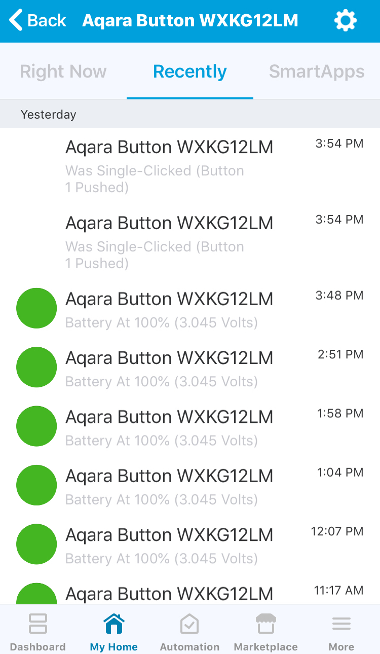

The display of “pushed” or “released”, etc. in the SmartThings classic mobile app is just for visual feedback. You should check the recent events in the “Recently” tab in the mobile app, like this:
The message “Was Single-Clicked (Button 1 Pushed)” confirms that the physical button push resulted in a SmartThings event which can be used with SmartApps for automations.
