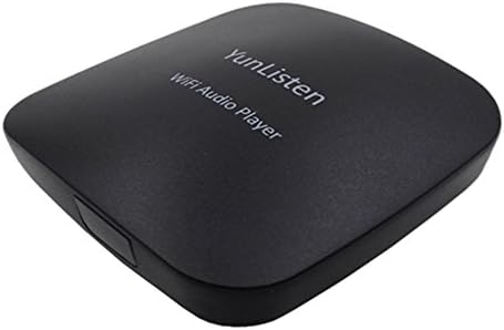

I just picked up this ultra-cheap DNLA receiver.
Note: As I am posting this there is a 10% off coupon. The coupon worked on their business price also–paid $25.20 with free shipping.
It worked perfectly with your DTH and Smart App. Thank you.
