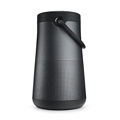

which of those are battery operated standalone Bluetooth speakers?
will this work with smartthings?
