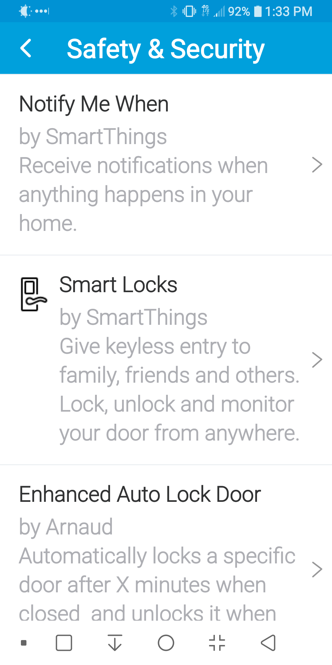

This is what I get when I click on Safety & Security.
I think you are still on the location with the ADT hub active on it. Exit that are and the click on the 3 lines in the uper left corner. Select the new location and the try the steps again.
You are correct. . . thanks! I switched to the new location and installed SHM. Now I have a second location with SHM installed but the hub is on the first location. Is it possible to move the hub over to the new location and delete the original location?
