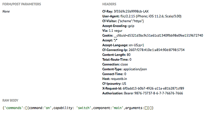

So next step was to debug this. So I created requestb.in inspection link.
Then I sent a CURL request to my requestb.in inspection link.
Then I sent a flic http request to my requestb.in inspection link.
They look the same for the required data.
The device is in the URL so I have to assume that this would be correct from flic.
The Authorization: Bearer token is in the header.
The Content Type is application/json
The body looks fine
Here are the two results from RequestBin
From Curl
Why would the Curl request work and the Flic request fail?
Could the api be blocking flic user agent?
Could the api be blocking the flic ip for some reason?

I hate to point out the obvious but the messages are not identical. The request-id and authorization are not the same. Also, the IP address is not the same. When you use curl, the request IP is the same as your hub. And flic’s is not. That might be what is causing the issue. If you issue your webcall to Webcore it is a LOT easier. Basically, all you’ll have to enter is the address like:
I know but they are just test messages anyway. As long as what I sent is what was delivered they are working.

In the end I found that the reason these two are the same is that I was testing using a different version of Flic and it was actually working. I need to go back and do the same test on the version I am running at home which isn’t working. I had assumed the approach I was using while away from home would work the same but it turns out it likely doesn’t. So I have to start my testing all over again.
