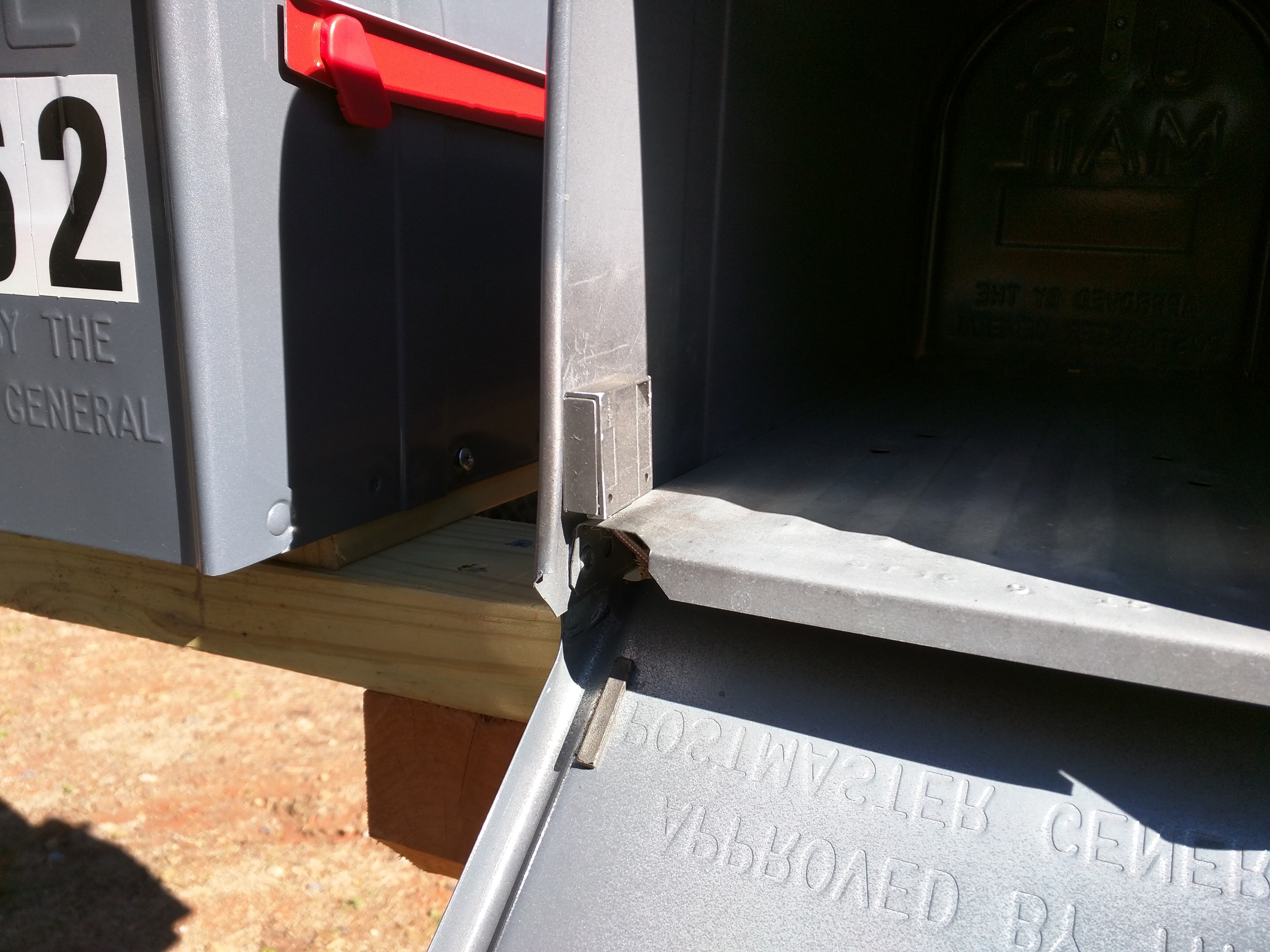

By far the best, cheapest ($27) and easiest sensor to integrate into a mailbox, simply mount to the door, the tilt mech is the best for triggering when mail arrives. The Ecolink works just like a door switch, you can have a push notification and even add a text to let you know when the mail man arrives. Nice to also add an alert if the door is left open for more and 5-10 mins (wind might have blown open)… The nice thing is this unit works on 3 VDC, so instead of using the 2 watch batteries which don’t work well in cold environments like Buffalo NY, I added a battery holder for 2 AA in series. This gives me over 10 times the capacity with a much cheaper battery. I got a plastic electrical box from the hardware store and bolted it on the door of a Step2 MailMaster Plus Mailbox. I packe…

I ordered the Monoprice Z-Wave plus door and Window sensor. I am not allowed to put holes in the mailbox. How big a hole are you talking about? Is that for the signal to escape? I looked a one of my other brand sensors and they have a copper stiff wire running along the side which I assume is the antenna.
I tried the Tilt sensor and it was broken two times do to it’s large size. That is why I went with the small Monoprice Sensor.

That was the first attempt which was a utter failure, tried a number of times in different seasons still no luck. I am stuck with the contact sensor, and will mount it on the door and the magnet in the box. I hope that will work.
