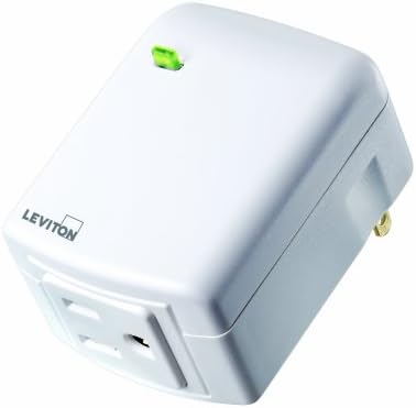

I also recommend the Iris outlet, IF you are good at copy/paste code in ide and have patience and willingness to pull your hair out…I have 10 of them around the house, but before I installed the last round, I shaved my head first. Really these are a pain to get them paired, but you can get the best of two worlds it repeats both zigbee and zwave (it’s actually zwave plus) and it helps beam to security zwave devices like locks. So it is a solid offer for the price you pay. If you are a plug and play kind of guy, I recommend the Leviton outlet, also mentioned in previous posts.

I was referring to the wired into the wall receptacle is what I typically have around my home, but I do have a little bit of everything device wise around my home. IMO if you have neutral wires in your gang boxes you should replace either a switch or outlet for the repeater in lieu of the pocket socket if it’s for something important like a garage door. There is nothing worse than counting on a close garage door command and finding out one of the kids unplugged a pocket socket so the signal can’t get through.
