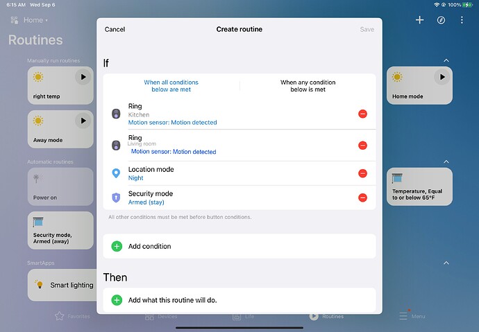

SmartThings routines allow you to have multiple conditions like
If The location mode is night
If the security mode is armed stay
if movement is detected in the kitchen
If movement is detected in the living room
AND/OR
Without preconditions, your choice to trigger the routine is
A) If all of these conditions are true
Or
B) if any one of these conditions is true.
