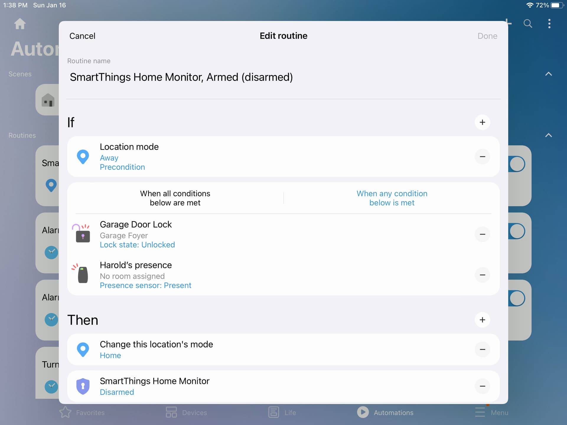

Here is the most simplest. This first image works but as soon as I add additional devices and change the when any condition below is met then the precondition does not get checked.

Mine originally included two preconditions and wo locks for the condition. Pretty close to @silverbullet07
The result was that the routine would run anytime the door was unlocked and ignore the precondition.
