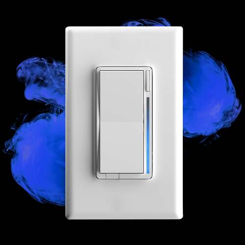

These days there are several US switches specifically designed to be used with smart bulbs. Rather than using the traditional “cut the current” method, these switches communicate via radio frequency either to the bulbs or to the hub. So they’re similar to something like the Hue dimmer switch, which is a battery powered switch that you stick on the wall, except that they are mains powered. They are just sending a message to the smart bulb to turn itself off rather than cutting the current.
So these are fine for using with smart bulbs as long as local building codes allow for them, which most do in the US.
I haven’t seen very many of this type for the EU or UK although Hue does have their dimmer module which fits behind the face plate.
Zooz has several models of this type, which have a “smart bulb mode.“
  • Smart bulb mode: disable the relay for truly wireless control or use as a remote control / smart add-on switch
Inovelli also offers similar switches with “smart bulb mode“ in multiple protocols, including Zigbee, z wave, and Matter over thread.
So these aren’t the least expensive smart switches you can find in the US, but there are some choices for this functionality.
