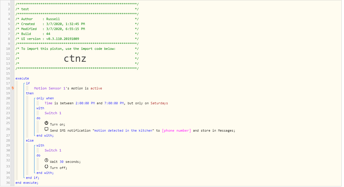

Thanks for the info. It was my understanding that this was the appropriate forum to ask this question about webcore - which is why I asked it here based on the title but then I realized afterwards that I wasn’t logged in to webcore community. I tried “exactly” as you described and still had to specify the the ‘Date and Time’ to make the light turn on . Specifying a “Time” only range just doesn’t make the light turn on. The consolidation completely makes sense provided that “motion changes to active” is valid for on/off. I will escalate my question to their forum to ensure I get to the bottom of way this simple action for this piston is not working. Thank you again.
The original piston you posted here should fire when the motion sensor changes state and at the start and end times of the time range. So the switch should turn on whenever the motion sensor detects motion between the given times, or if the motion is already active at the start time. It should also turn on if you hit the Test button when motion is active between those times. It the motion was already active when the piston started the switch wouldn’t turn on until it had gone inactive then active again.
What exactly wasn’t happening?
I reverted back to my original code which had the When Motion is “Active” and the switch does turn on but only if I specify the Date and Time…not just the Time. For the past 3 hours I’ve been playing with the settings and it seems to turn on with Time if I specify “2pm - 7pm - only on Saturdays”. It’s 6:58p here now and I’m not sure why it doesn’t turn on unless I make a large “time” range. It absolutely did not work when I was doing Time between 6:30 to 7:00p unless I put the Date 3/7/2020 6:30pm to 3/7/2020 7:00p time frame. Very weird!
Even after 7pm, it still responds to motion and I’m not sure why. Even with DST, that’s just an hour. There shouldn’t be a reason why it would need to have a 5 hour swing range to trigger.
turn on full logging for the piston and post those logs. also enable trace
To answer your question…when I press “Test” it displays logs. My apologies for the verbose. I will post this into the webcore forum in case.

There is something odd going on with timezones. You can see that the logs are timestamped for about 7:23 PM (EST?) but when there is a 30 second wait scheduled it is listed as 4:24 PM PST. The time comparison is using 4:23 PM for the current time, and understandably returning false when comparing it to 7:00 PM - 8:00PM.
Let’s start with the obvious one. As webCoRE uses your SmartThings location timezone, is your SmartThings location set correctly?
I say ‘start’, but I don’t know what I’d check next …
That’s it! My location was incorrectly set in the SmartThings Connect app and when I tried to set location correctly in Classic SmartThings app it would try but would default back to what SmartThings Connect was set. However, when I signed up for WebCore it was manually set to the correct time. This is now fixed and Piston now works. Thank you so much…this was driving me crazy!
