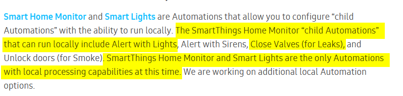

Hi …I stumbled across this…
I will have to shutoff internet and see if it works : )
Good catch with Smart Home Monitor (SHM), but with the new app it’s called SmartThings Home Monitor (STHM). I don’t believe anything (yet) with STHM is local.
Smart Lighting can’t use valves because it’s not looking for devices with “valve” capability. You’d have to customize a DTH for that, and then that will not be local to the hub.

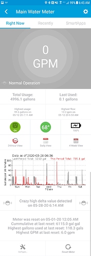

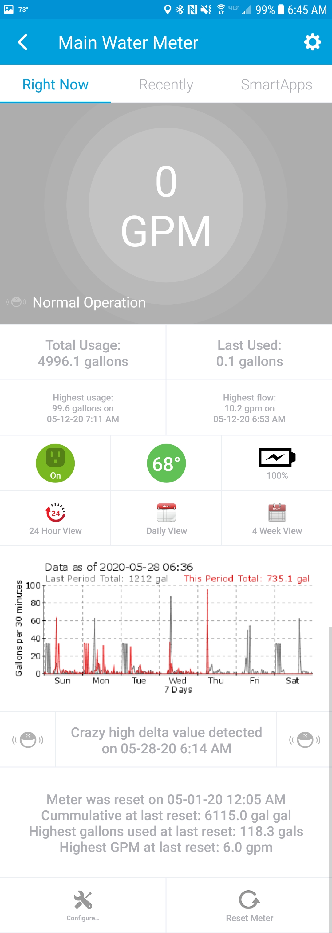

Here’s a flow meter I currently use:
https://www.fortrezz.com/flow-meter
It’s not cheap either, but it’s a heavy solid brass meter just like what you’d have in your home. My DTH is different than FortrezZ’s. This is one of my favorite devices.
wow that IS really cool ! Nice graphs and report.
But a little more than I wanted to spend : )

I did some testing and johnconstantelo was absolutely correct …
SHM (Classic App) will run locally and STHM (New app) will not.
This seems crazy that they would do this but…
Anyways, I will set this valve up when I get it under the SHM (Classic App )
