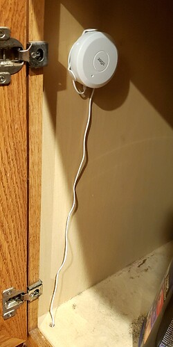

I use Dome sensors because of the remote sensor capabilities. This one is under the kitchen sink and the sensor lead actually sits under the dishwasher right next to the sink. I have similar installs in all bathrooms abd the laundry.
I do a wet test every 6 months and it reliably closes the valve within 90 seconds.

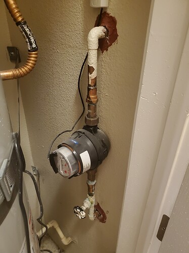

I don’t know if it’s sound or magnetism on the meter - but it’s surprisingly accurate. I did a measure on the bathtub last weekend (known volume, 25 Gal) and it nailed it. I’m sure it was off by some minor measure but it was close enough for what I need - I wanted some basic understanding of usage (check) and the ability to detect a slow leak without moisture detection which a water sensor can’t do… I couldn’t get it to detect a slow drip, but if you have anything resembling a stream it will see it. I think their software triggers on constant flow over some kind of timeout…
It’s supposed to… But I really don’t want to find out if it does. I don’t know the minimum volume / flow it can detect. But it caught me leaving my sink on a trickle…
I can’t speak to the leaksmart - but as you can see form the pic - the valve is industrial strength - that thing was HEAVY. My buddy who came over to sweat the joint for me is a master plumber - he said “Dang this is the heaviest valve I’ve ever installed.” Hyperbole or no - it’s STOUT.

Hi @mvevitsis, I’ll measure the meter’s length when I get back in town this afternoon. Based on your picture you may have to do some creative plumbing.
My leaksmart zigbee valve has also been rock solid. I like the battery backup feature too. You can manually turn the valve in the event of both mains and battery failure by removing the cover and 4 screws to expose the lever from the motor.
Hi @mvevitsis, the meter is exactly 12" long. That includes the brass adapters. You also should install the meter in the horizontal position.
Overall I’m very happy with the meter. It has it’s moments where it reports crazy numbers, but it’s not the meter. It’s the FMI that does that, hence why my DTH code looks for that.
I dont think so - it straps around your meter, there were no notes in the setup instructions about orientation.
