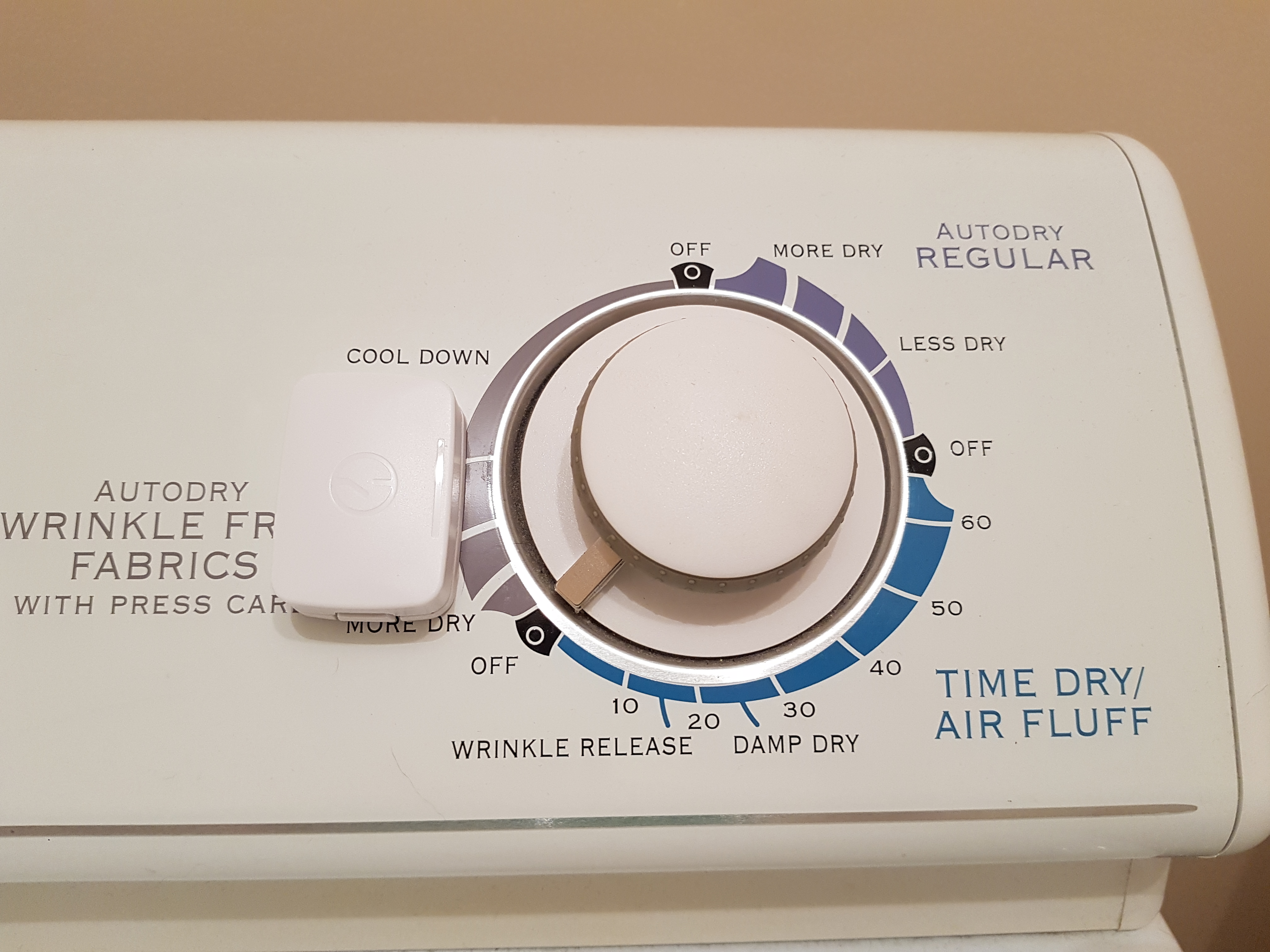

I tried a few things for my dryer and ended up using the multipurpose contact sensor. I just removed the magnet to place it on the dial and had to play around with placement of the sensor so it triggers in the right position.

Yeah I don’t use the vibration, found it wasn’t sensitive enough. I attached the magnet to the dial so it triggers open/close state.

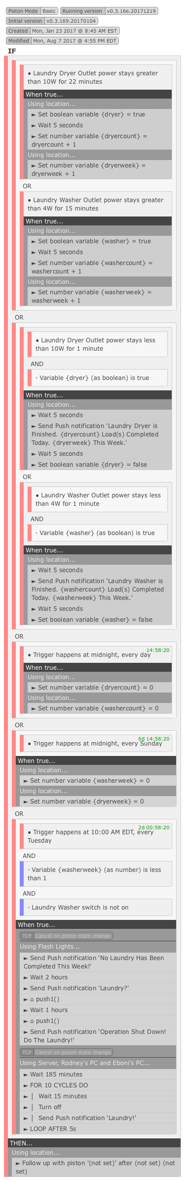

For the washer Alexa notification I installed the Alexa Switch Creator from the Community Installer. It can setup a virtual motion sensor and I have Webcore change the state based on the power outlet. Used something similar to what rotanlley posted.
Tried using the built in options for my Samsung outlet but found I needed the webcore for the draw and time settings. I guess the other option is to write your own smartapp in the IDE if you don’t want to use Webcore.

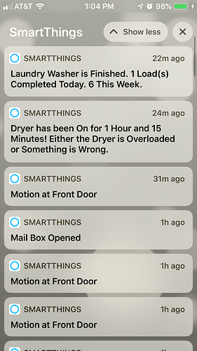

Love that I can keep track of loads and even announce when something isn’t right.
Sure enough, the kids had 2 blankets in the dryer which would not dry properly.

Yeah my dryer is 220v as well and that’s why I used the contact senor and just attached the magnet on the dial, picture in my post above. Simple open/close to see when it’s running.
