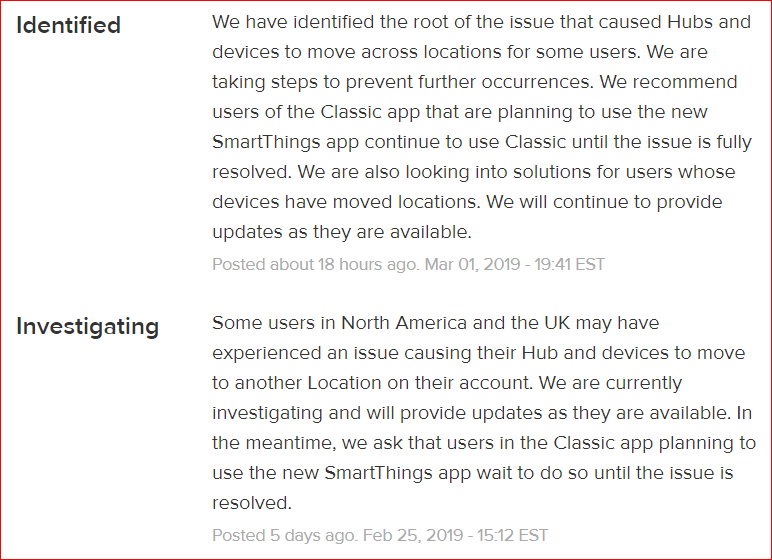

If I had encountered the current (over 5 day old!) “split Locations bug”, I would throw my Hub at the window:
