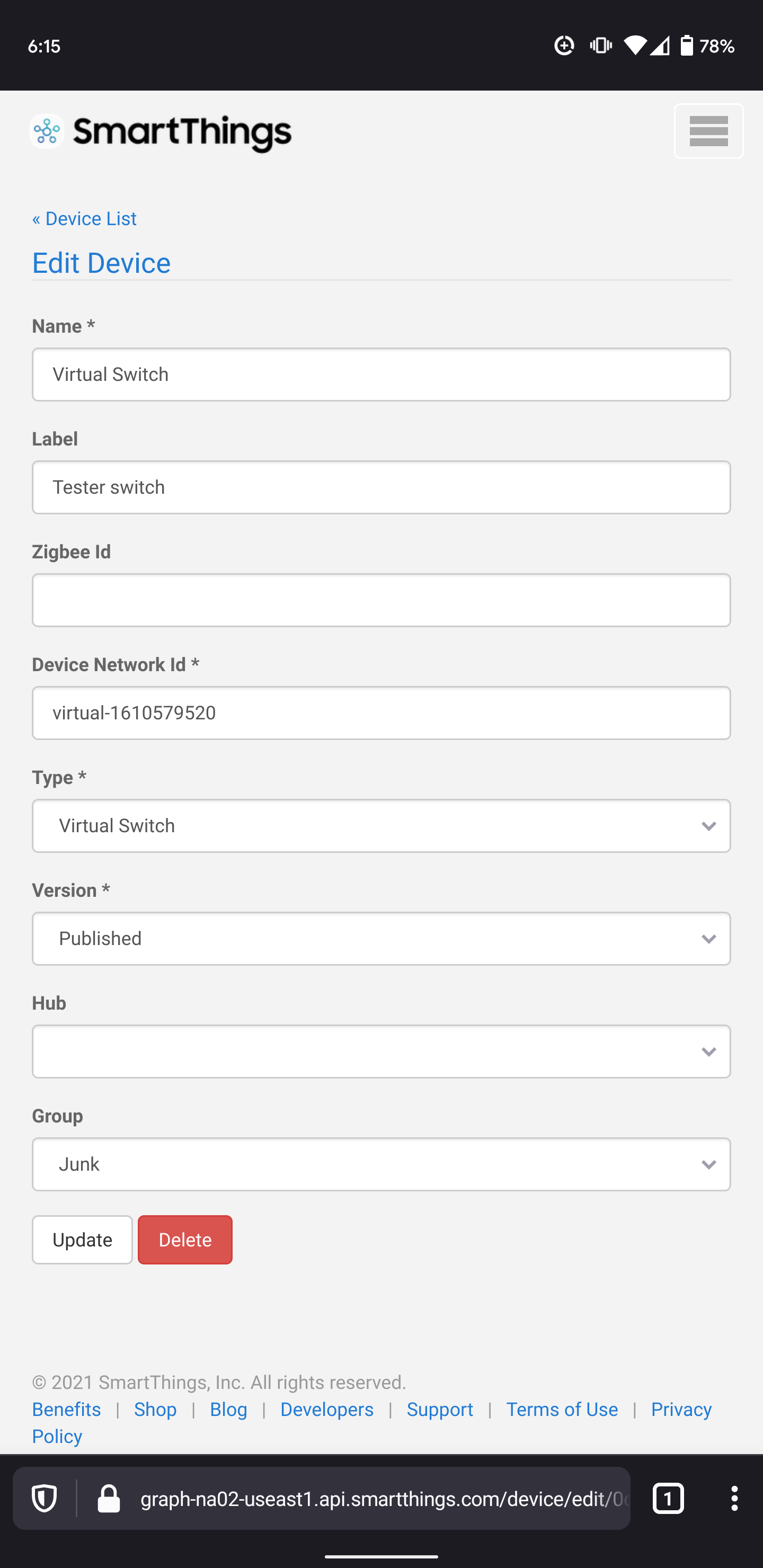

I don’t use Alexa so I can’t check that part of it. However, I just created a test virtual switch using this method and then checked the IDE and the type is listed as “Virtual Switch”.
