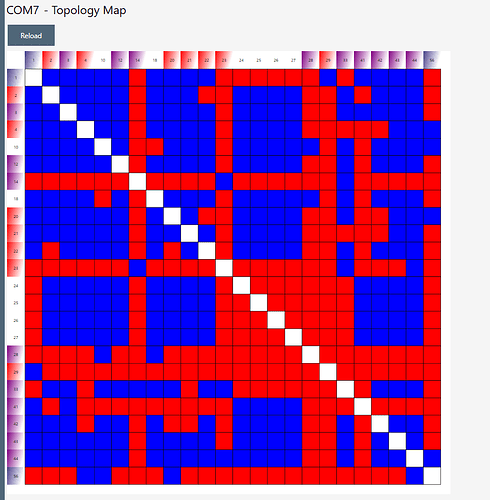

In my Map. number 29 which is Fibaro FGR-223 (roller shutter module) can only communicate with the hub which is about 15m away and therefore never respond to any message…
It use to work fine . I want it to communicate via 33 which is Aeotec Socket.
Z-wave repair never helped and waiting for the network to generate new routes never happen (i’ve waited few months). I Tried setup route, but nothing happen in fact I got this message:
when trying to set a 29 to 33 return route. I can live without 29 but it will be great to make it work again
Recopying your map here for discussion:
You can’t use set up route to create a hop where there isn’t one. The physical connection has to already exist, and then you can use set up route to give a priority to a particular possible set of hops.
Your map doesn’t show a path from 29 to 33– That’s why you are getting the message.
Where physically is node 33 relative to 29?

33 is in the celling in front of 29… About 4m distance
