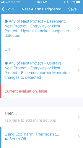

I’m doing this with Protect and Ecobee using CoRE. I also turn all available lights on. I’ve considered unlocking our doors as well via our Schlage Connect deadbolts.
WebCoRE is probably the best route that you can take. With this you can have multiple things (devices turned on/off) happen within your IF THEN ELSE statements.
The post by @616fun above is an example of how this was done with CoRE (older version of webCoRE).
Or as you mentioned in your post, you could do something similar with IFTTT when there is a “Smoke Alarm Warning”. With this method though, you are limited to one Action Service (one device) per Applet, so if you want two things to happen, then you would have to create two Applets. Not the method I would recommend.
