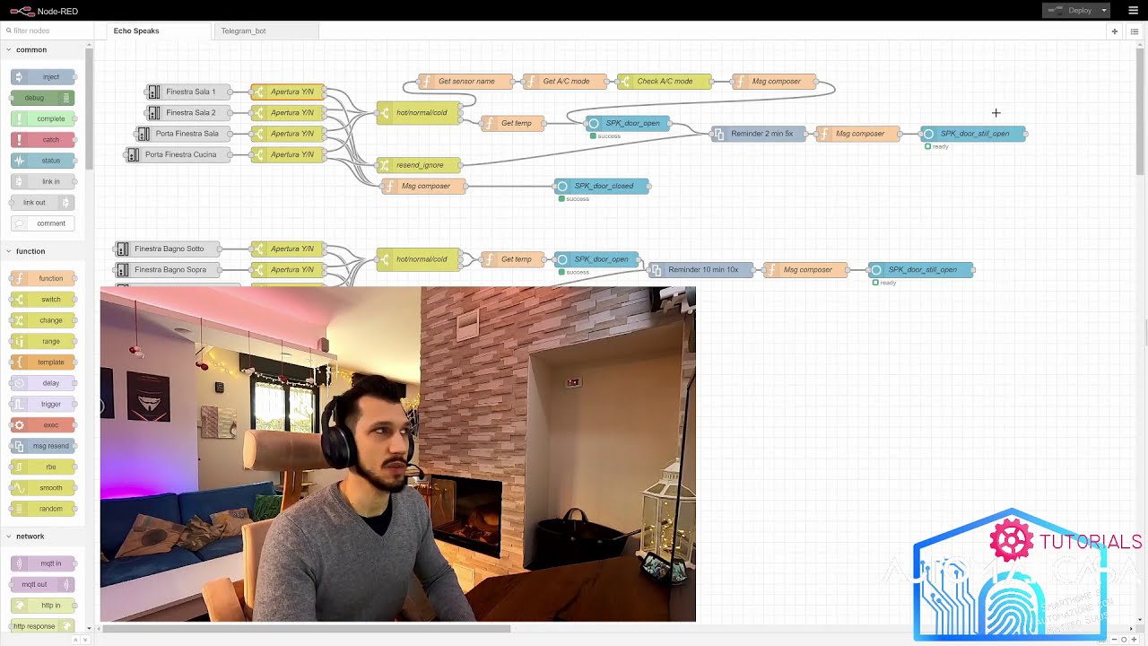

It’s not easy but I do that using NodeRed, a software installed on a Raspberry Pi (you can install it on any computer provided it stays on).
NodeRed integrates with Smartthings through a palette (on NodeRed side) and a smartapp (on ST side).
Node red has a palette for Google Home to cast TextToSpeech on Google Home or Chromecast devices.
So you can either.reat flows in nodered triggered by ST devices, or you can create automations in Webcore that trigger NodeRed Flows (e.g. a TTS action) through a Web POST that has inside as variable the text you want to pronounce.
Do you have detailed info on the setup for using this in ST?
I did a tutorial, it’s in Italian but you can probably follow the screens:
The NodeRed palettes are linked in the description.
The guide to setup the Smartthings palette is in the documentation of the palette, if you can’t follow the tutorial. Be careful that when in the smartapp you input the nodered machine IP (the raspberry pi in the tutorial) you need to add 'http:'before it.
In the tutorial I show the usage for the Alexa palette, but the one for Google is even easier, you just need to configure it with the Google Gome’ s IP address, and provide it with a payload with the text you want it to speak (it will make sense after you installed NodeRed).
Let me know if you’re stuck somewhere and I’ try to help.
