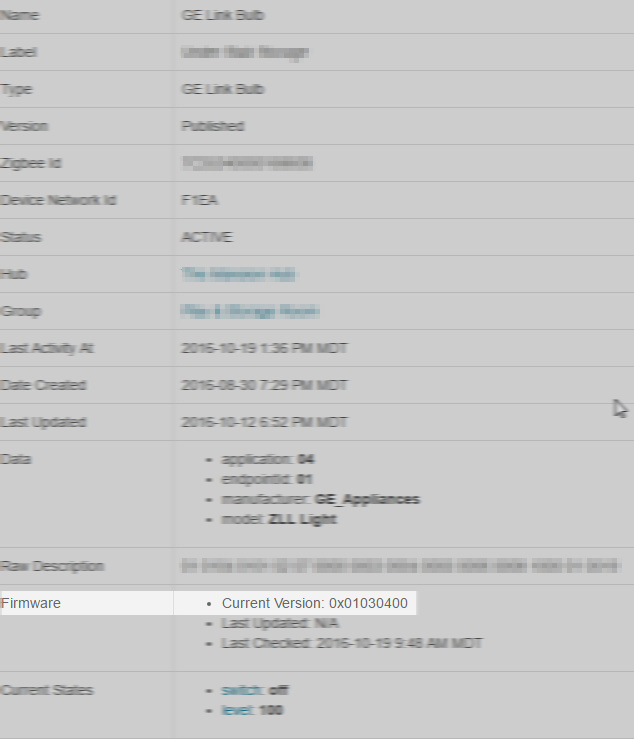

I took the plunge and bought a Wink hub to see if a firmware update would fix my bulbs. none of my bulbs updated past the revision that was already installed.
which should be the latest as of today since the Wink hub downloaded a bunch of firmware updates when i set it up.
So in theory if your Ge Link bulbs are reporting
That should be the latest and they dont/wont/shouldnt need an update. (which is sad considering the issues i am having)
On the Wink side of things the revision shows up as
So it seems like there never was an update to fix the firmware. My lights still drop off occasionally. I checked the firmware on my bulbs and they are all the same as yours. Most of my bulbs were bought back in 2014.
