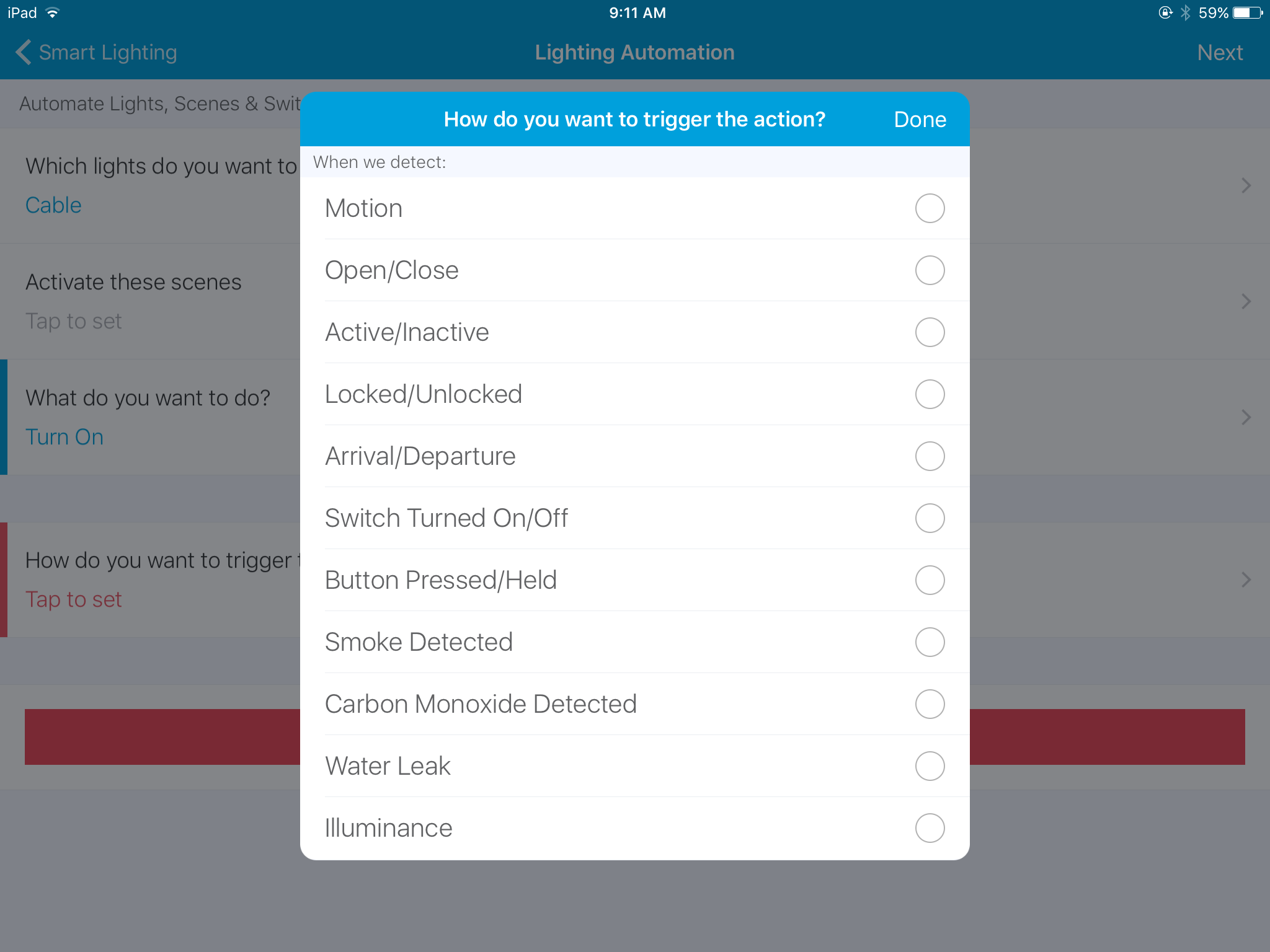

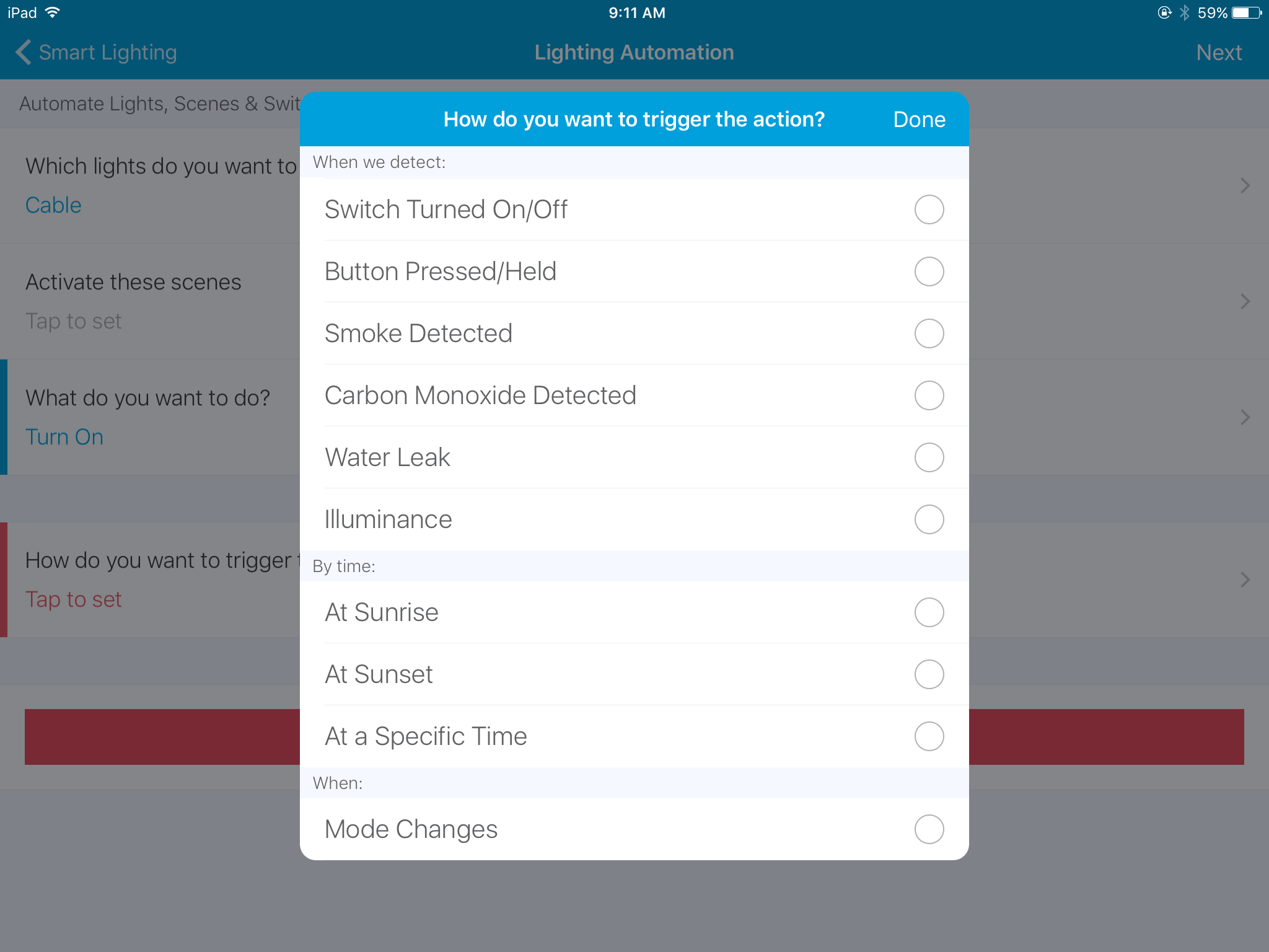

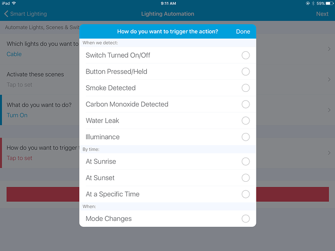

Doesn’t have humidity. Very annoying. Trying to turn on a fan when it gets too humid.
What doesn’t have humidity?
