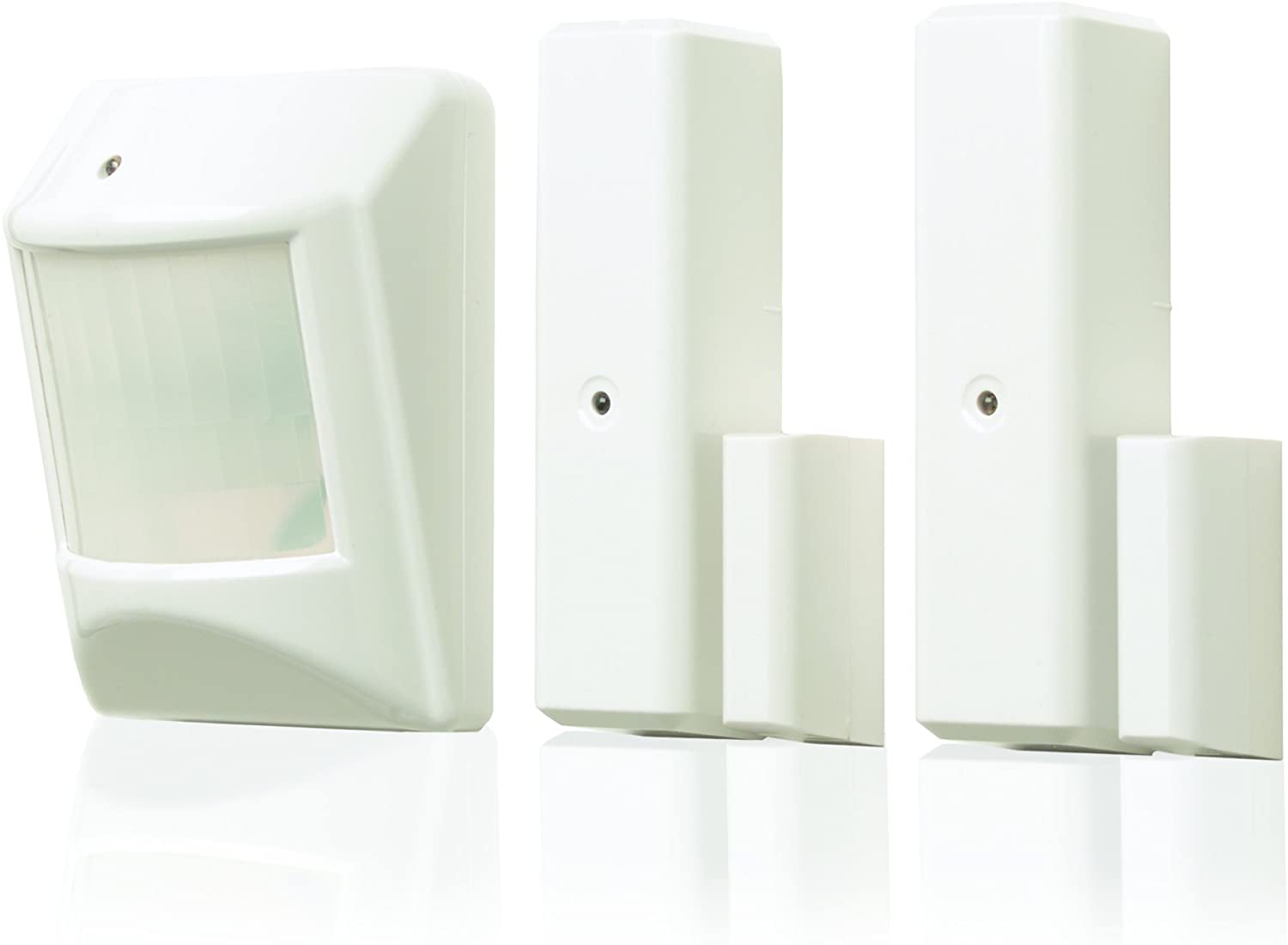

How is the pressure mat powered? I’m looking to install a similar setup, but are hoping to get a battery-powered pressure mat.
You need to use a contact sensor that has connections for an external input such as the GoControl Door/Window sensor and a modified DH mentioned in this thread.
https://smile.amazon.com/GoControl-Z-Wave-Door-Window-Sensor/dp/B00MNYSEF4/ref=sr_1_1?ie=UTF8&qid=1485792302&sr=8-1&keywords=go+control+contact
Might be cheaper overall to buy this bundle:
