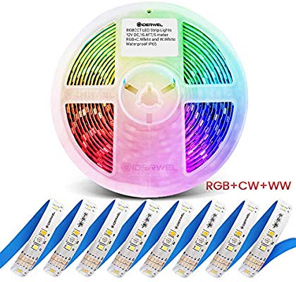

My standard solution
Strip:

I recommended an RGBWW strip over an RGBW strip as it gives you a dedicated white channel with bright white LED’s in addition to the RGBW LED’s… RGBW LED’s on their own don’t make a very nice white and are not as bright.
