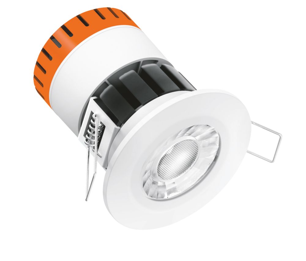

We, almost exclusively, unless specified, use Enlite E8/E5 - they have proven to be very high quality, low failure rate (1 in about 5 years, and it was one in my bathroom!) and they dim really well working along side an Aeon or Fibaro dimmer module which will connect into the first light in the circuit very easily. They dime down very low without any flicker (about 5-10%) and very smooth dimming which is hard to come by, even though LEDs have pretty much established themselves.
