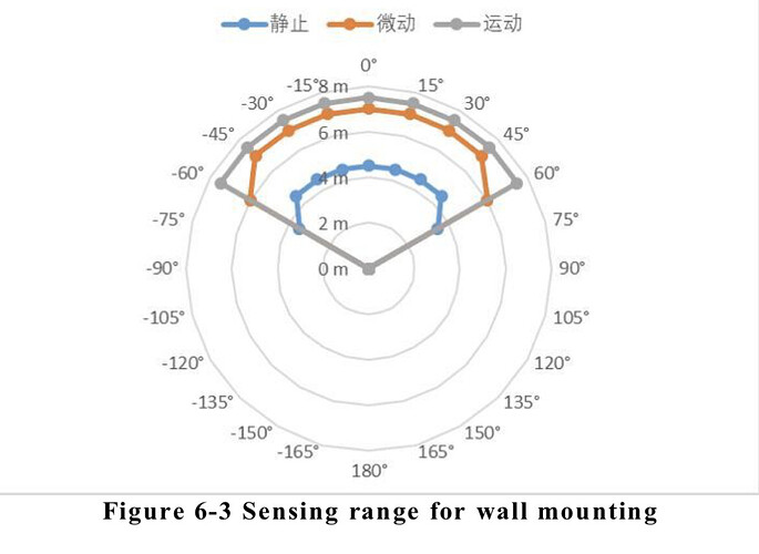

The sensor has a wide aperture (FOV = 120°) and is very sensitive to micro-movements such as curtains or plants swaying in the wind, … therefore it needs to be positioned so that it is not facing these moving objects, as this can cause the sensor to get stuck in presence detection. The angle and distance in relation to the target to be detected are also important (if you want to detect someone sleeping, for example, it is better to install it in a higher position). Regarding distance, although it can detect initial movement up to 10 meters, the mmWave detects movements up to 8 meters, and a static person up to 4 meters. This can be verified in the sensor manual.
*Blue line is the range for stationary target detection.
Sensor also has a precision of 0,2m to 0,5m.

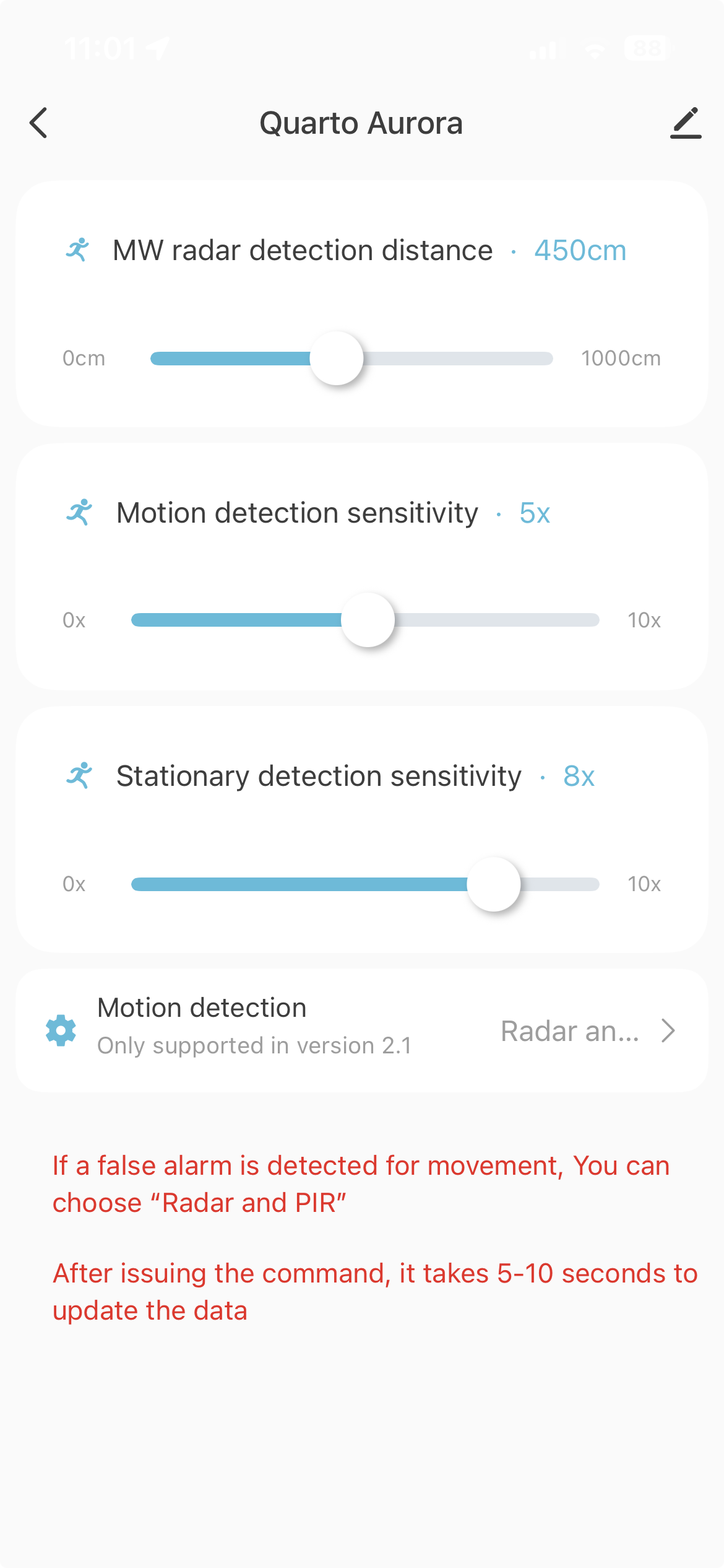

With all this in mind, after changing the position of my test sensors, I reconnected them to the Tuya Hub to adjust the settings. Factory reset them multiple times.
Bedroom:
For my bedroom, i’ve placed the sensor in the ceiling (2,5m high) in the middle of the room (2,5m x 3,3m), facing down just a little bit inclined towards the bed, and than set the mmWave radar detection distance to 4,5m (4,0m - 5,0m detection range), with this distance the FOV can cover all the room. Motion sensitivity (PIR) to default 5x, stationary detection sensitivity to 8x, motion detection = radar and PIR (pir detects large movements and mmWave locks in stationary targets).

For both bedroom and living room i set “presence keep time” to 300s, so it will release the presence status after 5 minutes of no motion detected.
This gives the mmWave radar more time to re-engage the target if tracking was lost in case of very small movements like breathing and heartbeat.
