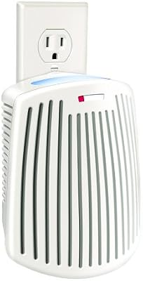

I have a similar setup. The litter box is in the small 1/2 bath between the toilet and the wall. I placed a motion sensor on the side of the toilet facing away from the door right above the litter box. This way it does not “see” people, but will see the cat. It also does not get any litter on it. I also have a smart outlet installed and bought this air purifier, however you can use any plug in air freshener.
For notifications you can setup either SHM -Custom or Notify Me When smart apps to notify you when motion happens.
