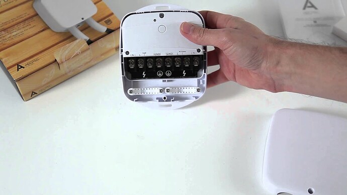

I saw that Aeotec makes a heavy-duty smart switch.
I installed it with a device handler that monitors energy usage and set an alert for when the energy drops below a certain level…indicating the heating element is off. Been working great so far for me!
How was the installation on this item? I’ve installed plenty of outlets in my life, but I hear there is not a lot of room in the housing. But if it does the job, I’d consider it.
My fear now is that I’ll install it, and then immediately the dryer that came with this house I purchased 23 years ago craps out right away lol
It’s not intended for inwall installation, you typically mount it on top of the wall nearby. It’s about 6” square. A lot of people use it outdoors for pool equipment.
It’s a white plastic housing, looks OK, so it should be fine on the wall of a laundry room.
It’s controlling the circuit branch, not the device, so you can probably wire it to the socket, not the device. Then If you replace your dryer with a new one, as long as it plugs into the same socket you don’t have to change anything about the aeotec device. I think the main negative with this one is the cost, it’s much more expensive than most of the other options.
I meant that my dryer will die, and I’ll get a smart dryer to replace it - thereby obsoleting the Aotec. My dryer of course currently (see what I did there?) plugs into a wall-mount 220v outlet in my basement, and it is that outlet I’d replace. Who knows, might be a good investment regardless
I mounted mine to the back of the dryer. Dryer to 220 smart switch, 220 dryer plug to smart switch. Worked fine. But if you think you’ll go all-in on a smart dryer…then perhaps just go for whatever coding is working. I have a brand new dryer, not smart, but now it is. The ability to kill the switch in an overheat situation is great.
