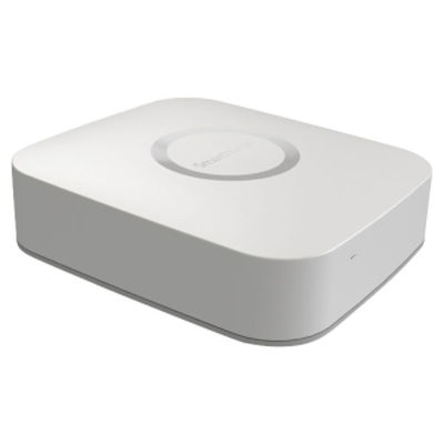

HI Guys! I am new to SmartThings, I am actually located in Malaysia and I am thinking if I should buy SmartThings Hub from the US or UK?
I done some research it seems both of the country has different version of frequencies on the hub itselfs.
Do look forward for some advises…
