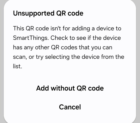

I have the Aeotec hub. I have installed the drivers for Third Reality and several others for “zigbee things”. If it makes any difference, I can share here the list of the drivers I have installed. Nothing. I cannot get it to pair with the hub no matter what I do or how many times I try. I unplugged and re-plugged the hub, I have taken the batteries from the switch a gazillion times… I have tried doing the paring with another phone (both Samsung phones)… I have cleared the cache on both phones, turned the phones on and off… I have tried deleting the Third Reality drivers and installing them again… I have gotten the device closer to the hub. I have tried scanning the qr code on the device, only to get this answer:

It has a different name because it’s a different device using a different protocol.
The BLE In the product name means it’s a Bluetooth device, and those don’t work with a SmartThings hub. At all. (You’ll see from the comments this model also works with a Different list of echo devices and it has shorter range.)
You’ll need to return it and get the Zigbee version. :man_shrugging:t2:
The one you have:
The one you need:
(It is quite common for Home Automation device manufacturers to use exactly the same outer case for multiple models using different internal radios because it costs them less money that way. But it can definitely be confusing to potential customers. :thinking:)
If that Amazon link is from your purchase history and it has actually changed, then Amazon had the listing wrong.
In your picture you can see your product model which is 3RSS009B, note the B for Bluetooth as @JDRoberts has already pointed out.
The one for Zigbee is 3RSS009Z.
