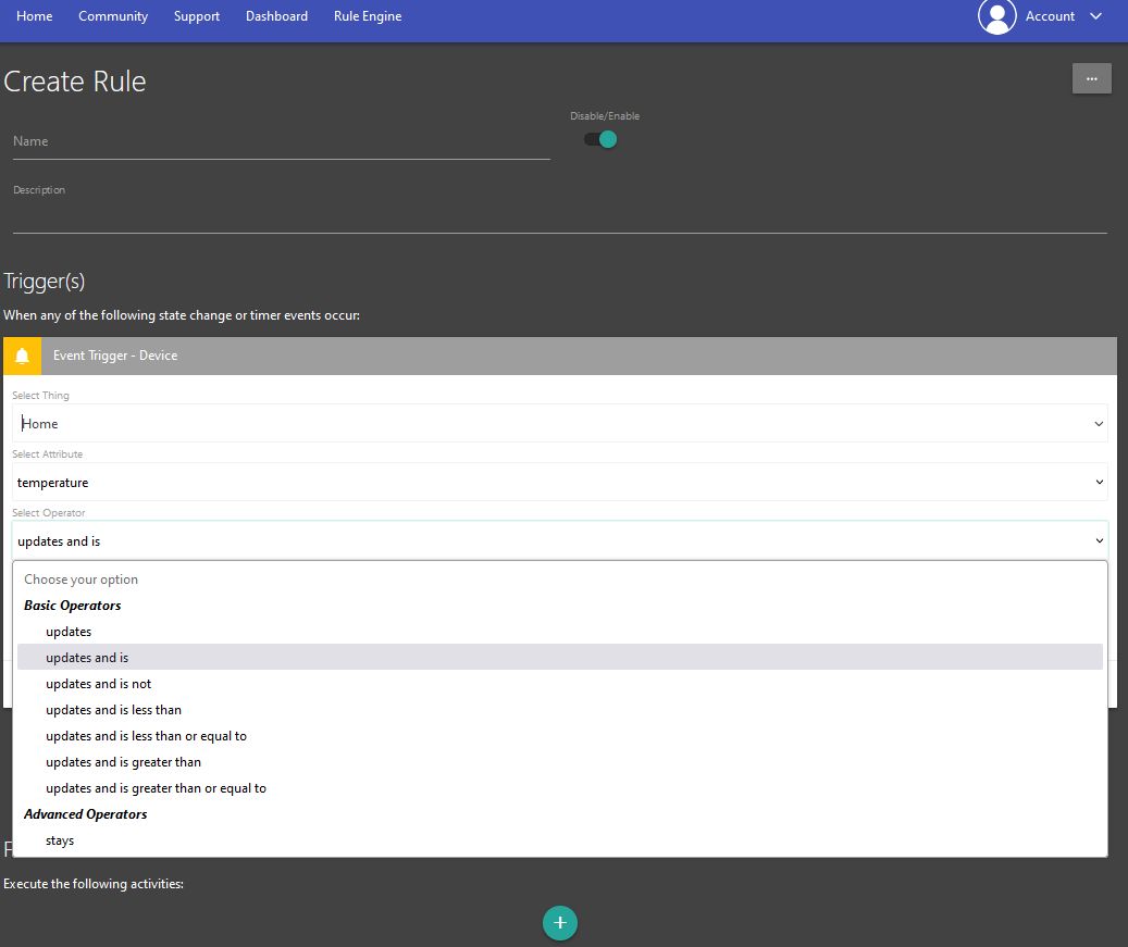

You might want to consider using a 3rd party rules engine like sharptools.io which offers more sophisticated routines with triggers like “Updates”, “Updates and is…”, etc. It also provides for separate Triggering Conditions and logic evaluation. Downside is your routines run in their cloud, but perhaps yours already run in the ST cloud, so…

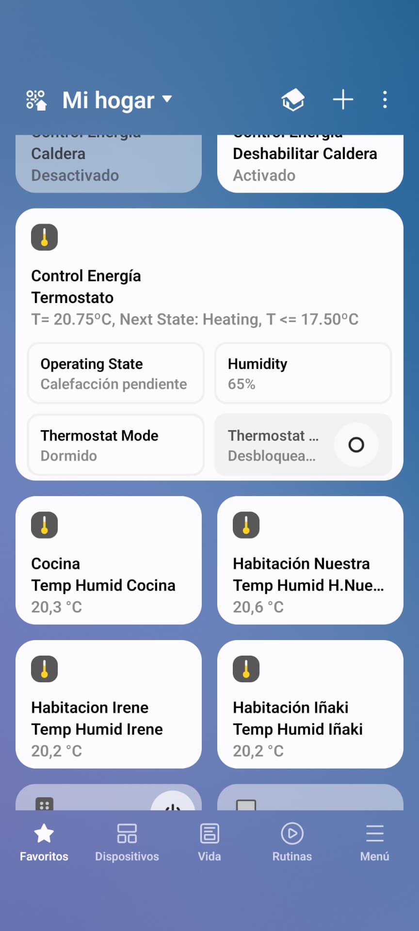

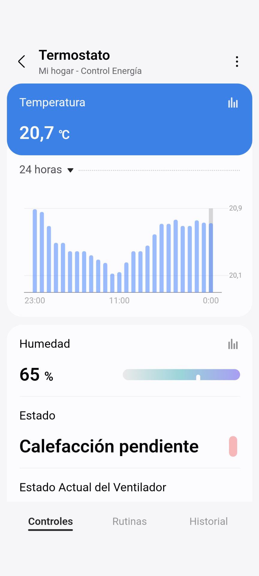

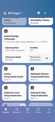

If it is so important to control your heating you can use your temperature sensor by creating a child virtual thermostat.
If it is zigbee you can use “Zigbee Temp Sensor and Child Thermostat Mc” and if it is zwave you can use “Z-Wave Sensor and Child Thermostat Mc”.
I have been using it for more than two years with Sonoff sensors and I control the heating in winter and the cooling in summer.
I have 5 virtual thermostats that control 5 rooms all day with different temperatures for periods (sleep, auto and rush hour), independently, with precision and automatically.
This is the user manual for the virtual thermostat.
Thanks, I’ll check out the 3rd party rules engine. That looks like it could be a solution.
