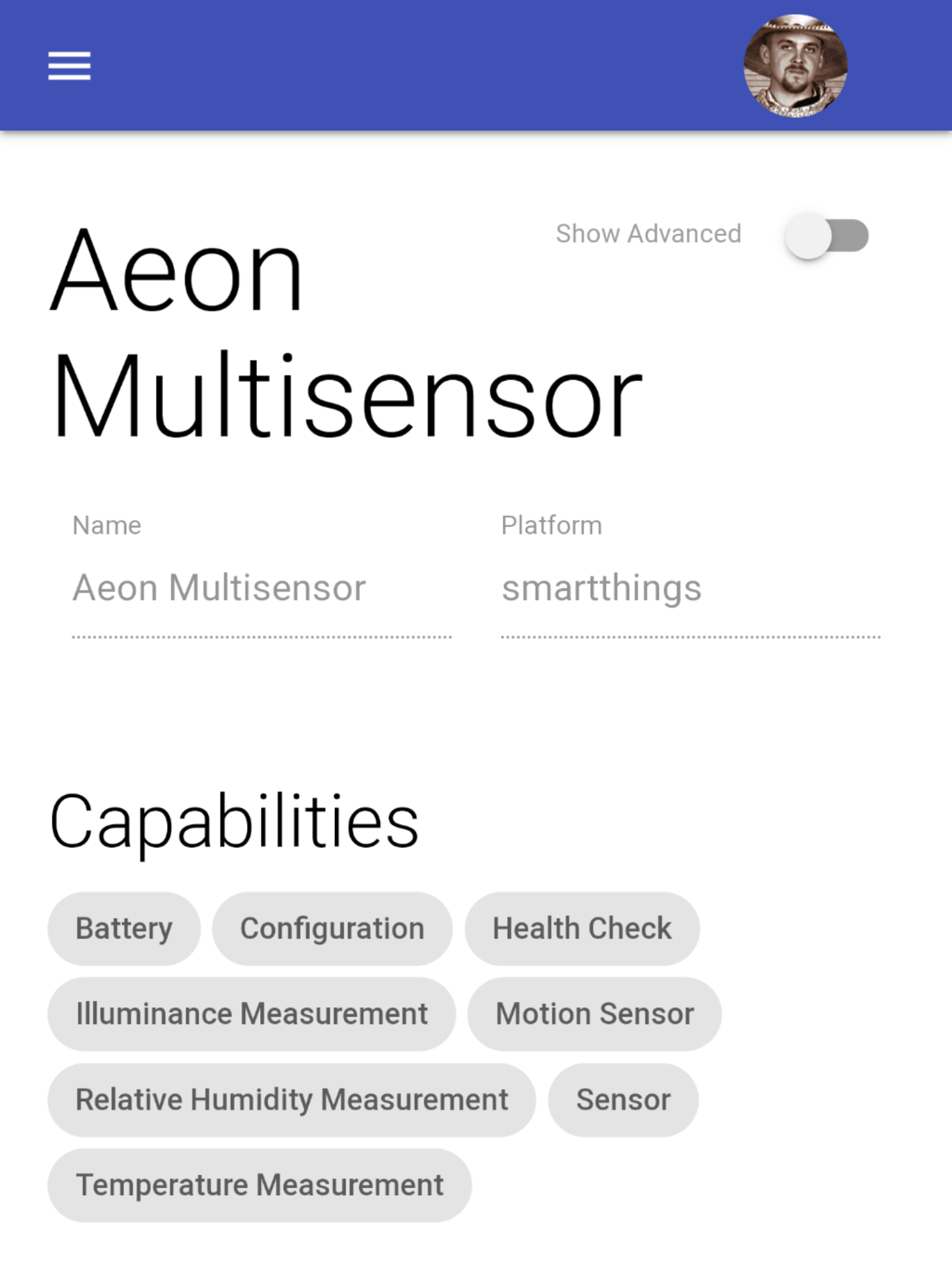

You could also connect it to SharpTools.io and then view the device details to see what capabilities it exposes.
After you’ve connected the device to SharpTools (via SmartThings):
  1. Open your SharpTools.io User Page
  2. Tap the … next to your desired location
  3. Tap on the Tailwind device in the list of Things
  4. Screenshot or copy and paste the capabilities here
Depending on what features it exposes, you could create a rule in the SharpTools Rule Engine to monitor it. :grinning:

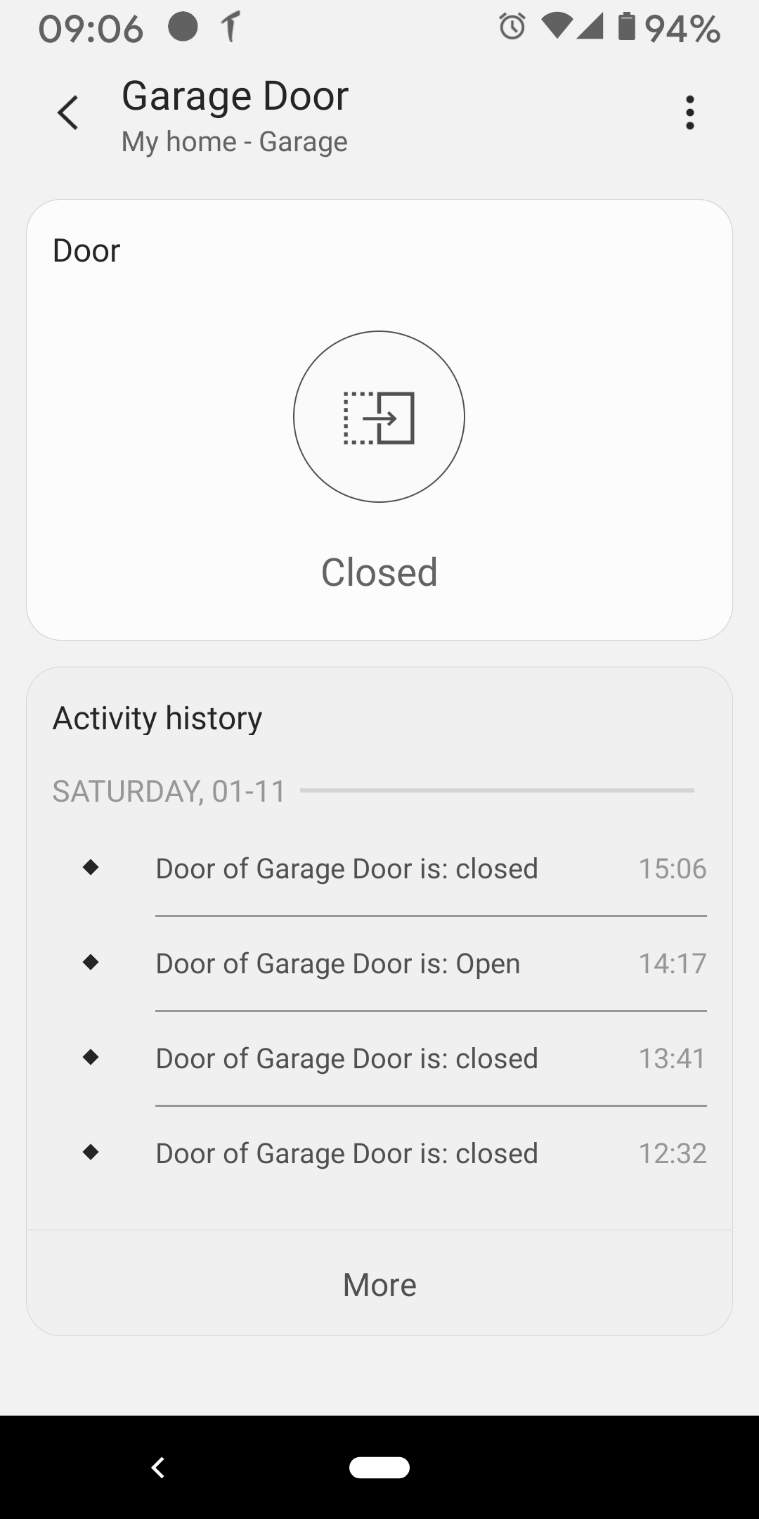

like this?:
Not quite. In the actual SmartThings app.
This one?
Yup. So that’s the problem. They’ve implemented it with capability door control (or garage door control), but not with contact sensor. STHM uses capability contact sensor.

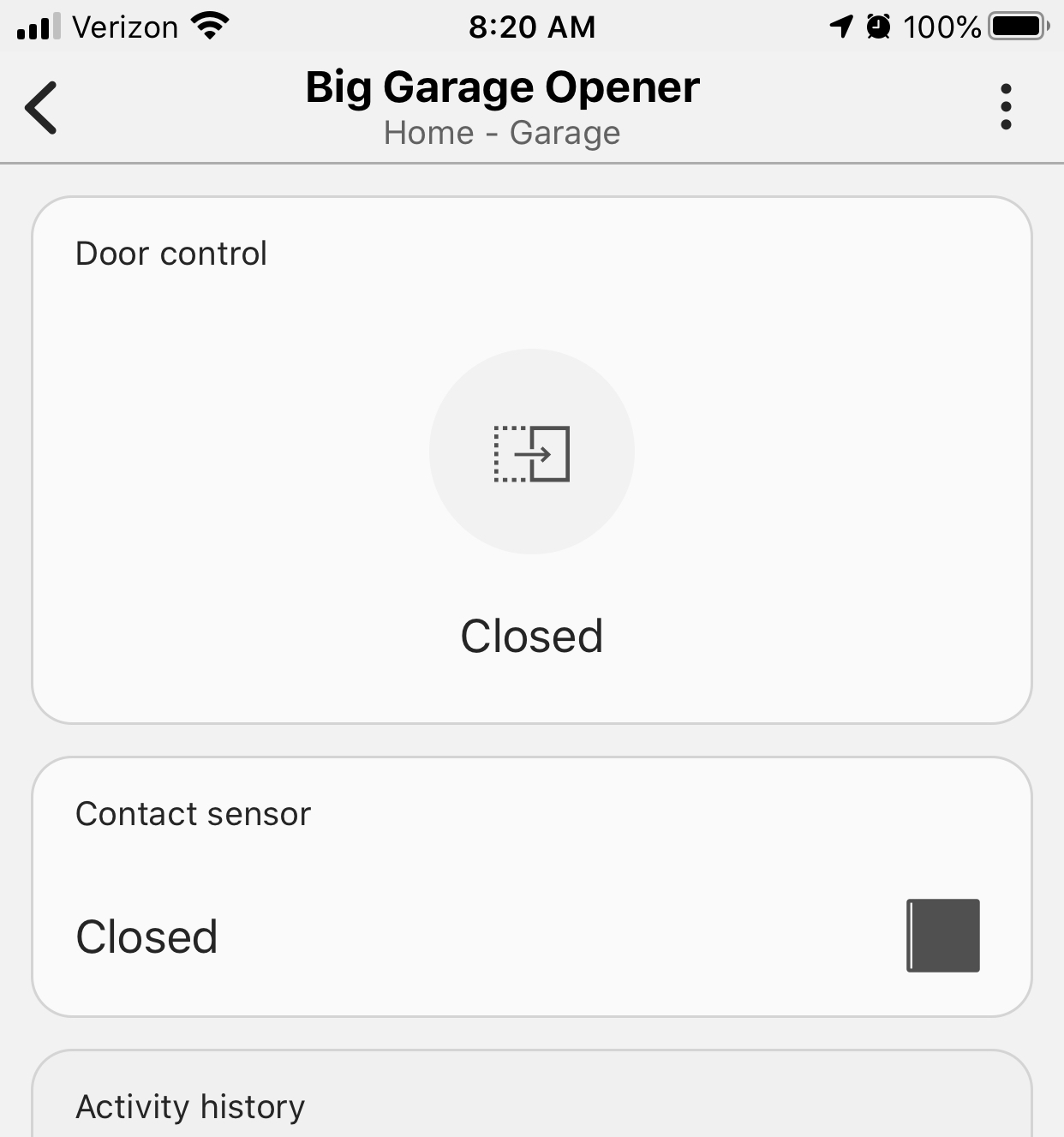

The z-wave handler includes both, so the device looks like this
You’ll need to ask tailwind to add the capability contact sensor to their SmartThings integration.
